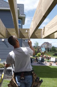

Structural hardware is designed — and its use is required by building codes — to keep decks and their occupants safe. Codes are catching up with the fact that the structure of decks differs from that of houses. Not only are a deck’s framing and hardware exposed to the degrading effects of constant weathering — something the protected interior framing of a house is never subjected to — but add wind uplift and the way we attach decks to houses, and it’s no wonder that today’s decks are strapped, bolted, and tied down at a majority of connection points. And changes to the 2012 code make it even more necessary for a deck builder to know his metal.

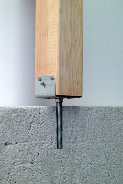

Height-adjustable post bases let you raise a post as much as 4 inches — handy if a footing settles or you want to adjust the pitch of a deck. USP’s version (APB44 for 4x4 posts and APB66 for 6x6 posts) costs about $7 and utilizes a threaded tube that is adhered or cast into concrete. A U-shaped bracket with a threaded rod gets fastened to the post bottom, allowing the post to be raised or lowered by turning the threaded rod into the tube. Simpson’s version for a 4x4 post, EPB44T (no offering for a 6x6), costs about $14 and uses a threaded rod adhered to or cast into concrete. After drilling a hole in the center of the post’s end grain, you fasten a U-shaped bracket with a nut to the bottom. To adjust the height, rotate the post and the threaded rod advances into the post’s hole.

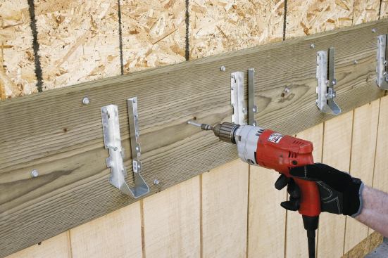

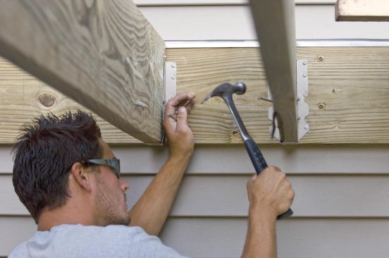

Joist hangers are for the most part old news, but there are a few innovative ones that will help you out with nonstandard framing situations. For the end joists, it’s been common practice to use a standard flanged hanger and then hammer the flange over onto the edge of the perpendicular framing member, typically the deck’s ledger. Aside from the sloppy appearance this results in, especially on an overhead structure that’s visible from below, there’s a risk the galvanizing may flake off when the metal bends, not to mention that the hanger’s warranty will be void (Simpson and USP state in their literature that modifications to their products void the warranty). Flanged hangers might also get in the way, depending on the location and layout of other framing hardware.
Concealed-flange hangers solve all those problems.  Their flanges bend inward toward the center of the hanger, giving the installation a clean, neat look. Unlike regular hangers — which you might fasten after installing the joists — you install concealed-flange hangers first, because the fasteners will be covered by the end of the joist. Note that the length of the joists will need to be 1/4 inch shorter due to the protruding fastener heads.
