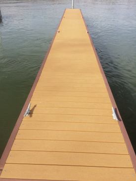

Contractors who continue to install uncapped WPC decking point to its proven performance. One of these is Monica Quinby, owner of Kingston, Tenn., Dock It, which builds upscale docks and marinas on local lakes and rivers. She has used MoistureShield’s uncapped decking for more than 20 years with no mildew problems, despite the damp waterfront environment. She also credits the product with quite good resistance to staining and fading.

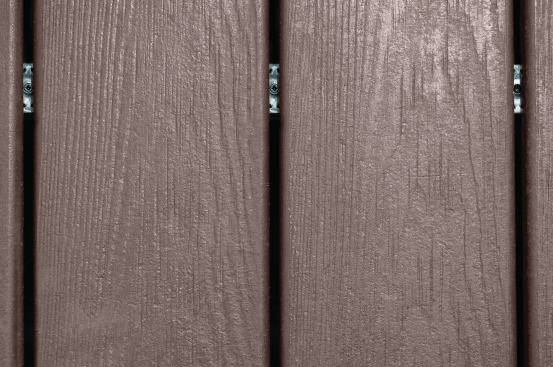

Uncapped composite boards are available in square-edged versions and in grooved versions for use with hidden fasteners, though Katwijk argues that the latter are not worth the cost for most uncapped-decking customers. “The extra price for hidden fasteners won’t fly with budget-conscious people,” he says. “Instead, I use color-matched screws from Screw Products and skip-screw so there are fewer screws on the deck. No one notices them.”
