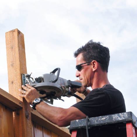

Figure 8. It’s difficult to set posts to exactly the right height. Instead, run them tall and cut them to size once the fence is built.

Once I’d set the posts, allowing them to run high, I let the concrete cure; then I pulled mason’s string tight across the post tops at the finished height and cut the posts 1/2 inch below finished height. I set the top of the top rail 6 inches below the post tops and set the bottom rail no more than 48 inches below the top rail (because of the subjective way in which this fence’s height was established, the fence height varied). Remember that I set the field posts at approximately 8-foot centers. Because of this, I used 10-foot rail stock so I wouldn’t have to fiddle around with an inch here and there. I just screwed the rails to the posts, marked them, and cut them to length on the post (Figure 15).

The longest run on this fence was over 100 feet. I had to snap the chalkline for cutting the tops of the slats off in three sections to minimize string sag, using the post tops as control points (Figure 16). A circular saw was used to trim the slats to the finished height (Figure 17).
Figure 16. Long runs of fencing may require snapping the cutline in sections to avoid line sag.
Figure 17. Cutting the slats off in place ensures a straight, continuous line.
