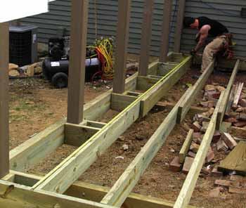

Figure 1. Housings assembled from joist stock and tied into the framing provide stout anchors for guardrail posts. Make the post opening a little big and cut the blocking a little short so it doesn't force the outer joist out of line.

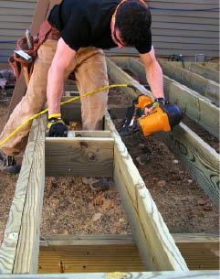

For added stability, I frame housings for the posts into the joists using blocking cut from joist stock (Figure 1). I cut the between-joist blocking 1/8 inch to 1/4 inch short because joists are never perfect and pounding in a block can easily deform a joist, especially one on a side of a deck. This, by the way, is when you’ll thank yourself for setting up a slide compound miter saw. It saves untold amounts of time and energy (Figure 2).
Figure 2. It takes a little extra time in the morning to set up a miter saw, but it pays dividends of fast and accurate cuts all day long.
I make the housings about 1/8 inch larger than the posts, which leaves wiggle room to slide the post into the housing. Later I’ll shim as necessary. It’s easiest to build the housings piece by piece in place, squaring them to the framing with a small square. I’ve tried making up blocking assemblies on the bench and then installing them, but I found it took more time.
You can use 3 1/2-inch screws or nails to assemble the housings. I drive a fastener into the top, middle, and bottom of the blocking at each nailing location. This fastening schedule not only makes a strong mechanical connection to the framing, it also leaves known areas clear of fasteners that could get in the way of drilling for bolts (Figure 3).
Figure 3. The post housings can be nailed or screwed into place. Locate fasteners where they won't be in the way later on when you drill for bolts.

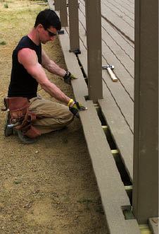

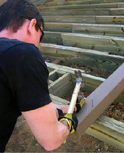

After cutting the post to length on a miter saw, I measure down the post to where it will meet the top of the housing, square a line across, and partly drive two nails right on the line. Slide the post into the housing, and the nails will keep it at the proper elevation until it’s fastened. This common trick, when used in combination with a housed post (compared with a face-mounted post), enables one worker to handle a post solo (Figure 4).
Figure 4. Nails driven partway into the post will support it at the correct height on the housing. This makes it easy for one person to plumb, shim, and bolt the post home.
For a rock-solid connection, whether I’m using composite or wood, I coat the interior of the housing with construction adhesive before inserting the post. With the post in place, I double-check that the bit won’t hit nails in the blocking, then drill two holes through the framing using a 3/4-inch-diameter auger bit. The holes go through the band or side joist, the post, and the blocking behind the post. One hole is drilled about 2 inches down from the top of the joist and the other about 2 inches up from the bottom.

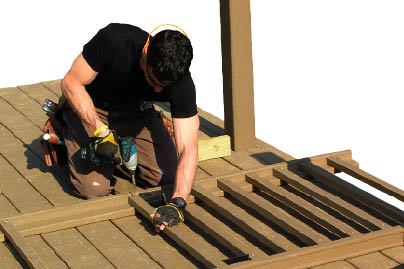

With the rails cut to length and spread out with the balusters on the deck, I’m ready to build the rail panels. In the case of the MoistureShield system, the rails are an L-shape that requires setting fasteners in the face of the 2×2 (Figure 10).
Figure 10. MoistureShield's rails are L-shaped and the balusters are face-screwed in place.
For wood decks, the top and bottom rails are 2x4s. I center 2×2 balusters on the rails using pieces of decking as a jig (Figure 11). One 3 1/2-inch screw in the top and bottom of each baluster secures it to the railing. While screws are best, gun nails work too; just make sure to keep the tool’s nose straight to prevent blow-outs.
Figure 11. Spreading wood balusters out on pieces of 1-inch-thick decking centers them perfectly on 2x4 rails. An impact driver makes quick work of the 3 1/2-inch screws that join the parts.
Figure 11. Spreading wood balusters out on pieces of 1-inch-thick decking centers them perfectly on 2×4 rails. An impact driver makes quick work of the 3 1/2-inch screws that join the parts.

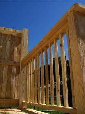

Install the Rail Assemblies
To keep the rail panel at the right height, I set it on blocks that are the same height as the toe space (2×4 scraps work great) then fasten the railing per the manufacturer’s instructions (Figure 12). The cap rail, which installs quickly, is next; it isn’t just decorative, as it also reinforces the railing attachment. With MoistureShield’s composite system, the cap rail fits between the posts and covers the top rail. For wood, if your railing attaches to the top of the posts, you’ll run the cap on top of, rather than between, the posts.
Figure 12. With a 3 1/2-inch toe space, you can rest the rail on 2x4 blocks for support while fastening it.
Figure 12. With a 3 1/2-inch toe space, you can rest the rail on 2×4 blocks for support while fastening it.
Without midspan support, most railings will sag, including those made of wood. The maker of MoistureShield requires this support, as do other synthetic-railing manufacturers. I use a piece of 2×2 (Figure 13).
Figure 13. Pieces of 2x2 support the railing midspan. Composite-railing manufacturers generally require this, and it's a good idea with wood railings as well.
Figure 13. Pieces of 2×2 support the railing midspan. Composite-railing manufacturers generally require this, and it's a good idea with wood railings as well.
