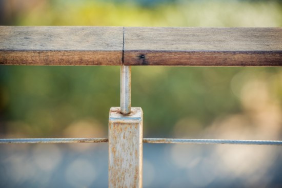

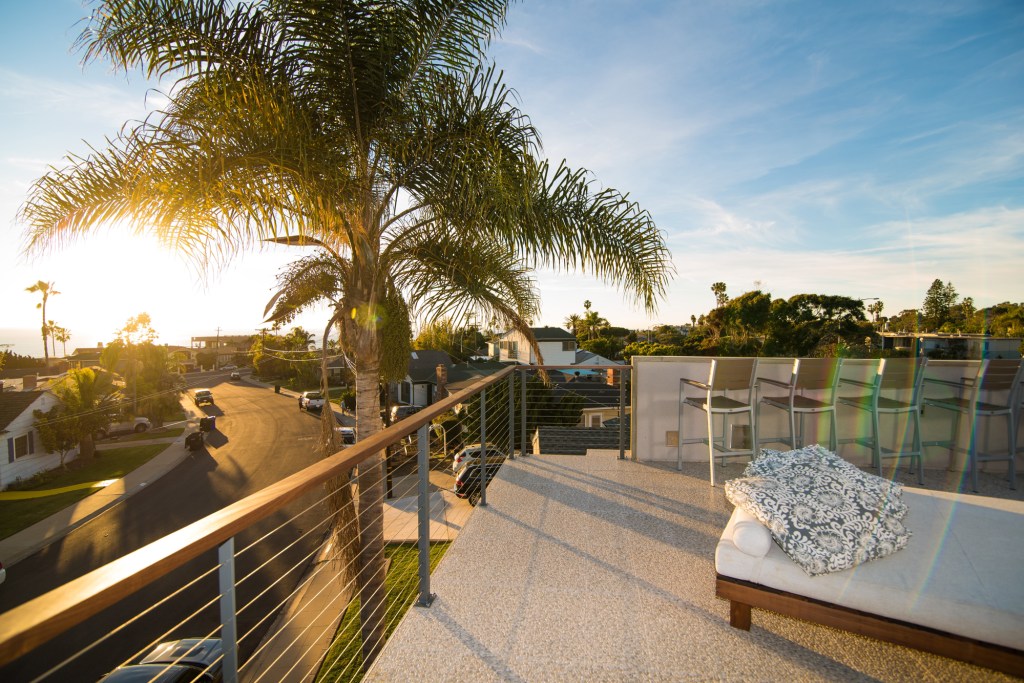

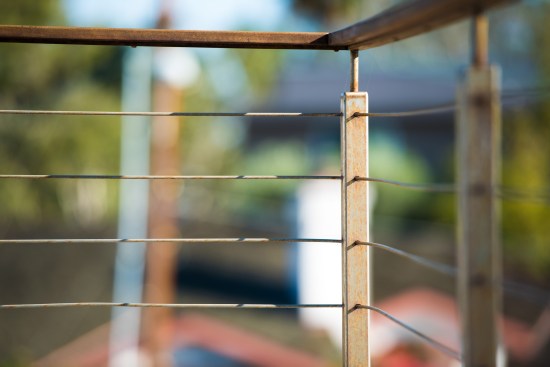

A recent upgrade of a cable railing during a deck-remodeling project in La Jolla provides a good case study. The deck and railing itself were less than a year old, so some of what we found was quite surprising considering the deck’s short life­span. But like many cable railing systems that we’ve encountered, this one wasn’t designed and engineered to withstand lateral and tension loads or to meet building codes designed to keep users safe. And this particular property is located only a couple of blocks from the beach, where materials are exposed to corrosive salt air.
Cable Railings Need Strong Posts
Even experienced contractors often underestimate how much tension is actually applied to the posts in a cable-style railing. One of the biggest design flaws on this project was the use of undersized, 1 1⁄2-inch thin-walled square stainless steel tube for the upright posts, which were fitted with small stainless steel pegs welded to the post tops for a standoff aesthetic. A thin piece of stainless flat bar connected the tops of all the post members and supported a thin ipe top rail. Under the cable tension, the pegs bent badly, allowing the ipe top rail to droop and warp. The cables then slackened because the flat bar and 3⁄4-inch-by-3-inch ipe cap rail weren’t rigid enough to provide lateral stability or tension resistance.
Though less than a year old, the existing T304 stainless steel railing was starting to corrode because of its proximity to the beach.

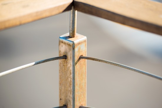

Besides being undersized, the original, single-corner posts required a sharp bend in the cable, which prevented proper tensioning.

When I first inspected the railing, I was able to shake it back and forth with little effort, and I was certain I could break it free from the deck if I tried hard enough. That’s because the posts were fitted with small, 2 1⁄2-inch square base plates that were attached to the deck with screws instead of lag bolts, providing a poor connection to the deck surface and little in the way of lateral support. When we removed the existing railings, we found that many of the screws had sheared off.
While the railing frame was built with stainless steel, a material that should last 30 years on the coast, the wrong grade was used to fabricate it. According to the owners, corrosion began almost immediately upon completion of the deck construction. No protective coating had been applied to the post members, and the railings had never been cleaned or oiled. When we inspected the railing, all the posts, cables, and fasteners exhibited some degree of corrosion.

An engineered system. The railing on this project was supplied by San Diego Cable Railings (sandiegocablerailings.com), a local vendor that also provides cable railing systems to contractors nationwide. SDCR offers quite a few post options in terms of appearance, but most importantly, the railing posts and connection details are engineered to sustain cable tension and resist lateral loads. Having an engineering report in hand makes the permitting process much easier and is a huge bonus during inspections.
SDCR railing posts come pre-drilled and pre-finished, complete with hardware and fasteners, step-by-step installation instructions, blocking recommendations, and tech support. It typically takes about three weeks lead time from the time the rails are ordered to the time that they are shipped.

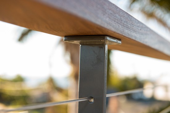

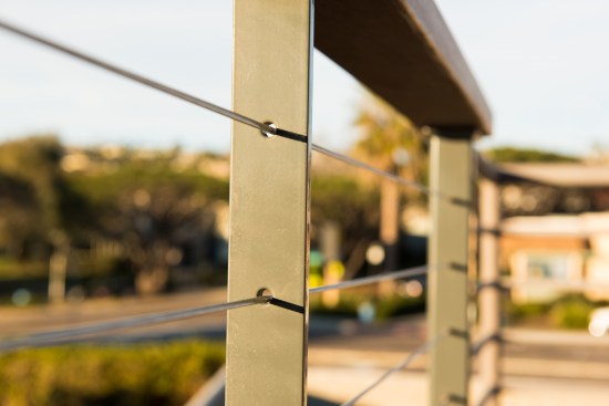

The new railing consists of T316 stainless steel 2-inch square posts and 1 1⁄2-inch-by-3⁄8-inch stainless steel flat-bar intermediate posts. We used the heavier, 2-inch posts at the ends and at the corners and alternated the sleeker, flat-bar posts between in order to expand the viewing windows. The maximum spacing—4 feet on-center—we used for the railing posts is a common requirement for cable railing.
Solid 11⁄2-inch-by-3⁄8-inch flat bar was used for the intermediate posts.

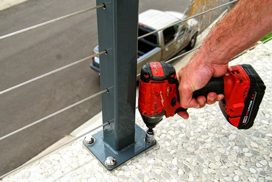

The posts have hefty 4-inch-by-5-inch base plates, which were fastened to the deck framing with 4-inch-long, 3⁄8-inch-diameter lag screws.
JUSTIN O’BRIEN
The 2-inch square posts have welded 4-inch-by-5-inch base plates, which we fastened to the deck framing with four 4-inch by 3⁄8-inch-diameter stainless steel lag bolts per post. Post installation is simple, thanks to the large base plates and the fact that the bolt holes are located farther away from the vertical post. This makes it easy to drill pilot holes with the posts in place, and then drive the lag bolts in with a small impact driver. The resulting rail system feels sturdy and extremely rigid, even before being connected together with the top rail.

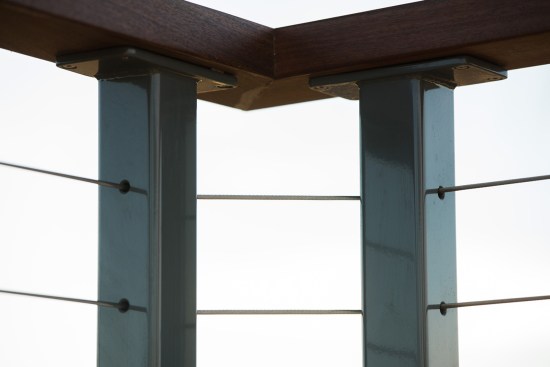

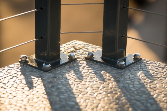

Double corner posts. The fabricators of the original railing used single posts at the corners. To do this, they had to drill holes on two walls of the corner posts and run the cable through the posts at a 45-degree angle. But architectural braid 1×19 stainless cable is considered semi-rigid and cannot bend or move at a tight angle inside a small, 11⁄2-inch square tube. As a result, the cables became bound at the corner posts, making tensioning impossible and creating extreme tension loads on the corners. Binding at the corners likely contributed to the broken fasteners and standoffs, due to the overloading of certain points on the railings.

The posts are equidistant and located a minimum of 4 inches from their centers to the corner, which creates a soft, 45-degree cable bend at
each post.
JUSTIN O’BRIEN
The posts are equidistant and located a minimum of 4 inches from their centers to the corner, which creates a soft, 45-degree cable bend at each post.
We replaced the deck’s single corner posts with two posts at each corner. Using double corner posts makes it easier to install continuous runs of cable without any binding and offers a cost benefit to clients because it eliminates a number of cable fittings. And mitering top rails at the corners is much easier with two posts because each railing member has its own mounting plate.

Ipe Top Rail
Because our clients were fond of the hardwood look of the original 3⁄4-inch-thick ipe top rail, we beefed it up by using stronger, 2×4 stock, which won’t warp under tension. The ipe top rail is directly attached to the welded post plate connections via four 11⁄4-inch by #10 SS screws with countersunk heads. Because of the strength of the ipe, there was no need for the continuous steel reinforcing subrail often used with aluminum railings.

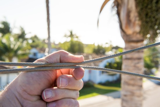

The 3/16-inch-diameter cables in the original railing had become slack.

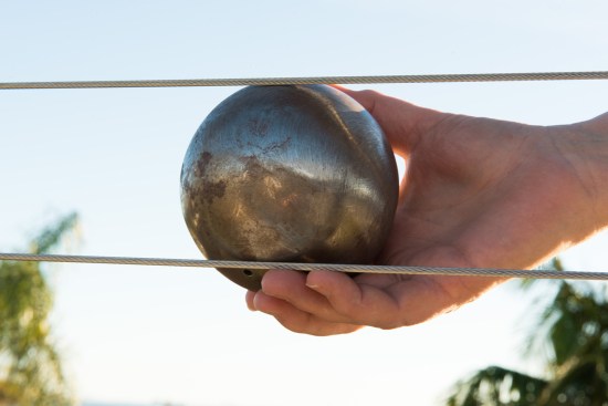

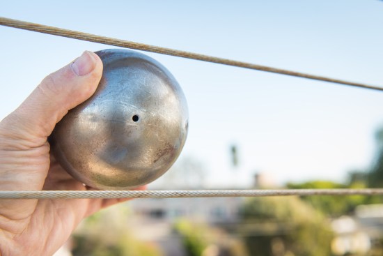

The cables used on the original railing were spaced 4 inches apart. This, of course, doesn’t allow for any cable deflection, and so the railing couldn’t satisfy the building code. Even had we been able to properly tension the cables, they still wouldn’t have been able to prevent a 4-inch ball from passing between them. To allow for deflection, we always install cables so that they are spaced no more than 3 inches apart.
It failed the 4-inch sphere test even when properly tensioned because they were installed 4 inches o.c.
BOB HOFFMAN

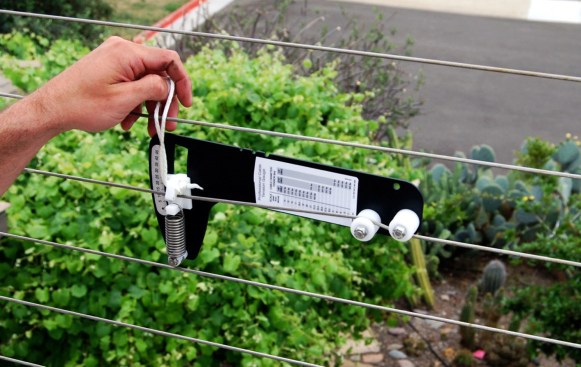

Another problem with the old rail system was that the diameter of the cables was 3⁄16 inch, rather than the slightly lighter gauge, 1⁄8-inch-diameter cable most often used on residential projects. Larger cable has less stretch and flexibility than 1⁄8-inch cable and requires a more rigid frame to achieve proper tension. Meanwhile, the undersized post members in this railing frame weren’t even adequately sized for 1⁄8-inch-diameter cable.
When tightening fittings, the author makes sure to allow enough adjustability so that the tension on the cable can be increased later.
JUSTIN O’BRIEN
A tension gauge is used to indicate when the cable is tight enough, typically at 150 to 200 lb. of tension.

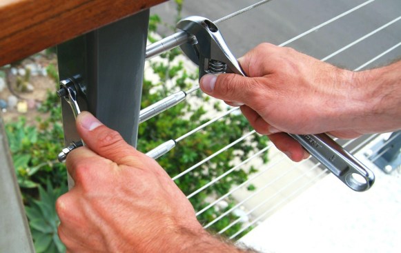

The 1⁄8-inch T316 stainless cable that we installed had factory-swaged threaded studs at the end of each section. We provide SDCR with the exact dimensions of the deck (this can be done with either a line drawing or a photograph) and it precuts the sections, allowing about a foot of extra cable per section to make it easier to pull it through the railings. Once the section is in place, either a swaged or—our preference—a swageless terminal is installed on the other end.
Most field-installed cable fittings these days are swageless, where the cut cable is inserted into a fitting that works like a finger lock. In our experience, many installers bottom out the fittings during the initial installation and tensioning, so that there isn’t enough adjustability for someone to return and tune up the cables later on. Having sufficient—but not too much—“take up” to achieve proper cable tension is key. Typically, we find that cable installed with 150 to 200 lb. of tension will satisfy most inspectors.

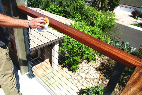

On completion of any cable railing installation, we always thoroughly clean the cables and post materials with a high-quality stainless steel cleaner that contains a bit of oil. We also recommend periodic cleaning, which offers extra protection from the elements and keeps the railings looking new.
When installing fittings, we apply a touch of anti-seize grease to the threads to prevent any binding of the tensioning nuts. Lubrication is especially important for coastal cable railings to prevent salt intrusion between the threads.
Routine cleaning and maintenance with a penetrating oil finish is needed to keep the ipe top rail looking good in a marine environment.
JUSTIN O’BRIEN
For finishing ipe, we prefer to use Penofin’s hardwood penetrating oil finish. We’ve found that if the wood is kept clean, penetrating oil products can be added as needed (sometimes one to three times a year). Different levels of exposure will require different application rates, but it is a nice brush-on-and-wipe-off product with good longevity.
