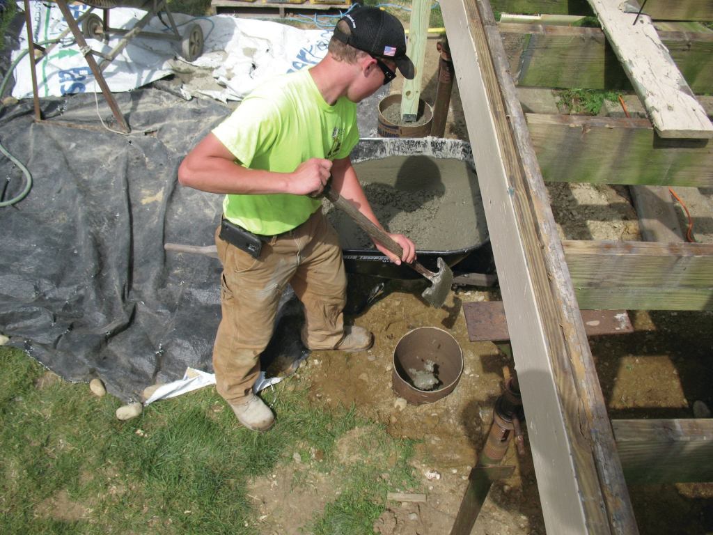

In Mike Guertin’s recent article “Better Deck Piers” (Feb/Mar 2015), the question is raised about whether or not the mass of the concrete used to build a deep frost-protected deck pier needs to be factored into the deck load calculations used to determine the size of the pier’s footing. In that article, the author concludes that the difference between the weight of the soil removed from the footing hole and the weight of the footing and pier is minimal, and that the 10-psf prescriptive dead-load capacity is probably enough to handle the difference. But it’s worth looking at this question more closely, because it relates directly to efforts underway to develop prescriptive design methods for typical residential deck footings.

How is it, then, that 10- to 12-inch-diameter piers 36 to 48 inches deep have historically performed adequately in many regions of the country? Generally, there are two answers: minimal loading and skin friction (also called side shear).
Minimal loading. It’s fair to say that most decks never realize the live loading potential of 40 psf; the majority of decks on single-family homes support only the family and a handful of guests. If we assume an average weight of 200 pounds/person (conservatively high), then a deck should be able to support one person for every 5 square feet. That translates to 20 people on a small, 10-by-10-foot deck—standing room only! This is an unusual crowd for a residential deck and I’d stay inside, but it is what we’re supposed to be designing for. With that in mind, perhaps many piers are undersized.
It’s also worth noting that the actual dead load varies considerably from deck to deck. For example, a deck with joists 12 inches on-center will have twice the dead load per square foot as one with joists 24 inches on-center. If that deck also requires deep frost-protected piers, following the 10-psf prescriptive path for dead loads will provide very little reserve bearing capacity to accommodate them.
Skin friction. In engineered systems where a comprehensive soil analysis has been conducted, such as a pier foundation (one much deeper than frost depth) supporting a home, the designer is allowed to consider the bearing resistance due to the friction between the soil around the pier and the sides of the pier. And as anyone who has ever pulled an old pier during a deck rebuild knows, a 36-inch-deep, cast-in-place deck pier also gains some bearing resistance from skin friction, particularly when full-depth forming tubes haven’t been used. Breaking it free of the earth takes more force than moving just the weight of the pier, and that resistance works the same for downward pressure. On the other hand, engineered pier foundations for homes often discredit approximately the uppermost 10 feet of soil, which is where a deck pier would be located.
