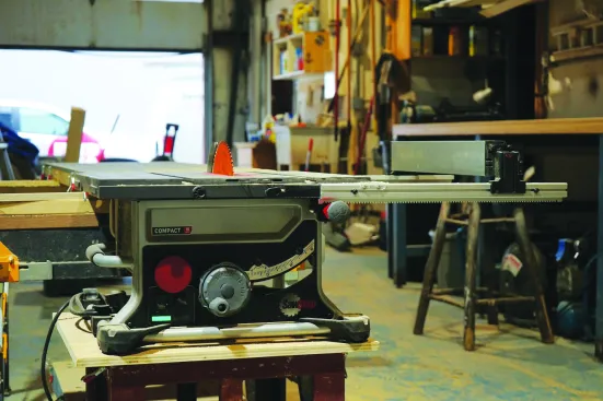

The first thing my coworkers remarked on was the saw’s size and heft. “You won’t cut off your finger but you will throw out your back,” my manager joked. Its weight and size offer an upside and a downside. Anyone expecting a tool like the Dewalt jobsite saw, which is light and easily portable, is liable to be disappointed by the CTS’s 68-pound weight. When set up, however, the CTS is a beast with ample power. I ripped several hundred feet of mahogany and it didn’t falter. Its 10-inch blade powers through material, and the large table, not quite a 2-foot square, provides a solid platform.
Nathaniel Carlsen
The SawStop CTS provides 24 1/2 inches of supported rip capacity with a sturdy base—the saw weighs 68 pounds.
Indeed, the big table is one of the things I love about the saw, because it elevates the tool beyond a simple ripping machine.

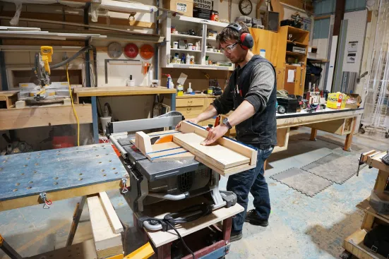

I’ve also been impressed with the cut quality. I am in the process of building a variety of router jigs, which involved a lot of crosscutting. Before building my crosscut sled to accomplish the task, I evaluated and tuned the CTS for blade alignment. While the CTS came relatively aligned, some adjustment was needed. Thankfully, this is a fairly simple process, and the difference was noticeable: Cuts improved from what I would expect from a jobsite saw to buttery smooth. Using the saw to build a loose tenon jig, I found the saw quite capable of the accuracy I needed.

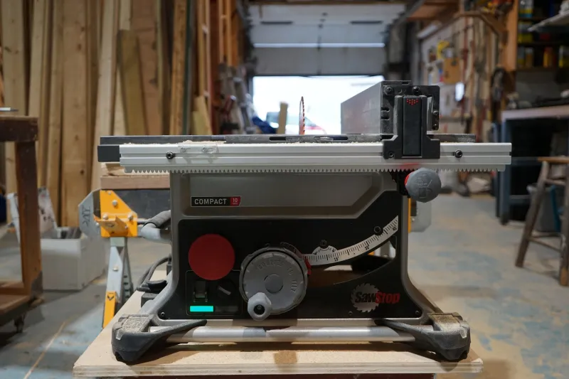

The details of this saw are reminiscent of other jobsite saws, with the rack and pinion fence that seems to have become a standard feature in this category. One difference is that SawStop has changed the locking mechanism, opting to locate it within the adjustment knob in a pull-to-unlock, push-to-lock action. I find the force that’s needed to lock the fence a bit too violent for my taste, though I have never noticed any movement of the fence as a result. Over time, however, I have come to appreciate the ability to adjust and lock the fence with one hand, although the mechanics of doing so took some getting used to.
The bevel adjustment mechanism is a dream and housed around the blade-height crank. The bevel mechanism is unlocked by pulling on the surrounding housing and locked by pushing it in, with the entire blade assembly able to tilt to angles that range from -2 degrees to 47 degrees. Where SawStop really pushed the envelope on the bevel adjustment is with the micro adjust feature, which allows the ring that locks the bevel to rotate and adjust the bevel angle very slowly, click by click. This makes achieving an exact angle incredibly easy, which is a rarity in saws of this class.
