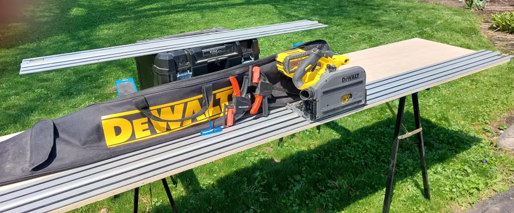

Tool descriptions often get overdone with words like “revolutionary” or “game changer.” In a rare case, I will come across a tool type that actually improves my work. Finally buying a track saw was one of those cases. The DeWalt DCS520B cordless track saw was not a purchase I made lightly, because of the cost, but I have not regretted it. With any track saw kit, buying the saw is only one part of the investment. You need tracks, track connector, clamps, a track carrying case (optional but good protection for the tracks), and the saw. All told, for my setup I was in for around $800. I was able to bundle the purchase to save on cost, so if you are in the market, for whatever brand, keep an eye out for this kind of offer.
The saw has a 6 ½-inch blade, offers a soft start, and can plunge-cut through material up to 2 1/8 inches thick at 90 degrees and 1 5/8 inches thick at 45 degrees. The depth of cut and bevel are both accurately controlled by easy-to-use dials and stops on the top side of the saw. The blade is guided during the cut by the grooved track where. The light aluminum track has foam strips (replaceable) on its base that help keep the track in place for quicker cuts. And a slot on the base allows for clamps to be fitted to ensure no track movement when accuracy is vital. Each track can be linked with a connector bar to allow for longer runs—the individual lengths available from DeWalt are 46, 59, and 102 inches. The rubber strip on the two long edges reduces splintering, shows where the cut line will land, and is also replaceable when it wears with use. The result is very straight cuts with very little tear-out.

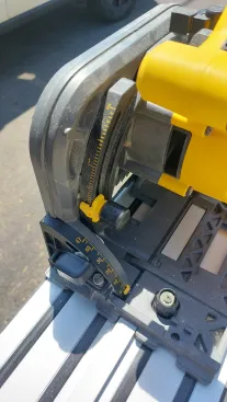

The depth and bevel controls are readable and accurate, with bevel locks at both front and back.

The butcher’s bill for the setup that I have if you buy them separately: the saw (bare tool), $490 with one battery; the charger, $580; two 46-inch tracks at $87 each; one 59-inch track at $90; the track bag, $45; clamps, $30 (not DeWalt but others work fine); and the track connector bar, $40. I also picked up a single hex key for $5 that fits the connector bar screws (the bar doesn’t come with one). Again, there are bundles (and sales). The DCS520B is an investment, but I’ve made it back in what I have been able to produce. Available at Dewalt.com.
