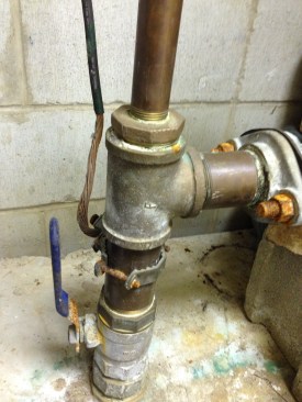

Bonding the Water System
Even if the water system for a house enters in plastic pipe and is not used for the grounding electrode, the copper piping of the water system must be bonded to the electrical system ground. This ensures that no stray voltage enters any metal plumbing components or fixtures.
When attaching a bonding wire or electrode conductor to a water pipe, use grounding clamps designed for water pipe attachment. If a water meter is present, two clamps must be used, one on either side of the water meter, with a bonding jumper (ground wire) in between (below).

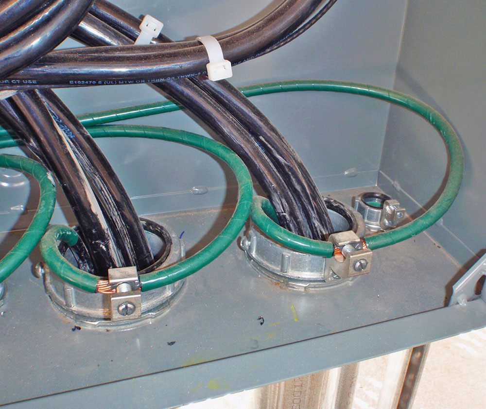

Bonding Service Equipment
All enclosures of the electrical service must be bonded to the service grounding system, including any meter sockets or metal junction boxes (see Figure: System Grounding, above). All metal boxes in the building’s branch circuitry must be bonded. Non-metallic boxes are not required to be bonded, but the branch circuit’s ground wire must extend to any fixture or device that is installed in a non-metallic box.
