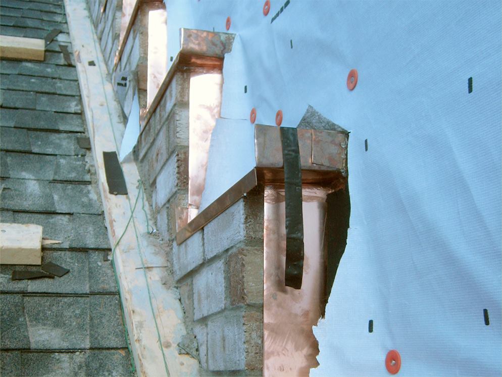

Rarely does brick as a material fail. The challenge is making sure it's supported properly, that it’s securely tied to the structural wall, and that the measures have been taken to ensure that moisture won’t affect the wood framing behind brick veneer.
