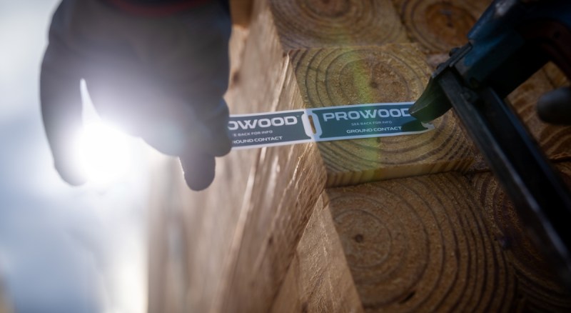

The end tag on every piece of treated wood includes the information needed to help contractors make the right choice for the job.

Because retention levels vary with the type of preservative, the contractor should specify treated wood by Use Category. It’s easy to confirm that you’ve made the right choice: The Use Category and the retention level are listed on the tag stapled to the end grain of every piece of treated wood.
When placing an order with the supplier, it’s important to specify the correct Use Category—but the crew receiving the lumber should be trained on how to read these tags so they can make sure the supplier sent the right boards. “The framers should check the use category to ensure that the material was treated for the conditions it will see,” says Munson. Some suppliers only carry ground contact-rated wood, but checking the tag is still good practice.
End tags from a reputable manufacturer also include other useful information. “The tag should specify the use category and should confirm that the company follows AWPA standards,” says Munson. “There should also be a check mark confirming that the product meets building code specifications.”
