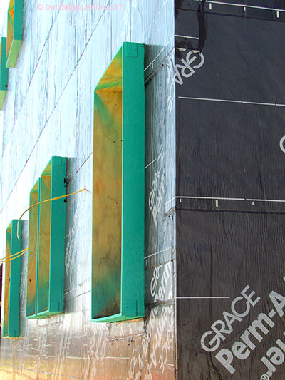

Once you get used to the terminology, it’s easy to zero in on Joe’s approach. In this article, it focuses on getting the water-control layer right for “innie” and “outie” windows in walls with exterior insulation:
“If the windows are ‘inset’ [innies]” Joe explains, “and the water- and air-control layers are behind the continuous insulation, everything is real easy—things ‘line up.’ If the windows are ‘outset’ [outies] and the water and control layer is the face of the continuous insulation things are also real easy—things also “line up.” But if the windows are outset and the water- and air-control layers are behind the continuous insulation things get more complicated.”
It’s this last case, which is what you need to do with an “outie” window when using mineral wool insulation (e.g. Roxul), where this article becomes especially interesting, providing insights we haven’t seen lined-out so clearly before. In this case, the face of the insulation can’t be used as the water-control layer the way you can if you tape the face of rigid insulation. This means you have to control water at the face of the structural sheathing with an effective WRB. To integrate this WRB with window flashing, Joe’s solution is to install plywood bucks (as shown in the photo above) which get “picture framed” with 2x2s so the extension is wide enough on its face to integrate with the window flange. He then recommends smearing the whole thing with a liquid-applied flashing to provide continuity with the water-control layer on the face of the structural sheathing. The liquid-applied flashing wraps into the frame opening and creates the “pan flashing” for the opening. The window installation can now proceed, following the same steps as for the “innie” approach. Read more.
