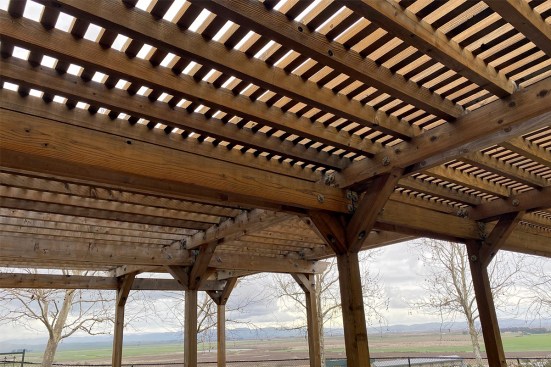

One rectangular-shaped pergola, for example, measures nearly 117 feet in length, covering an expanse of 3,516 square feet. In total, raceway pergolas offer about 9,000 square feet of shaded area.
“No 2x4s or 4x4s were used for these pergolas. They’re made with big pieces of redwood, 6×6 posts, 3x6s, 3x8s, 3x10s, up to 20 feet in length, and 3x3s on top. They’re massive,” says Olhiser

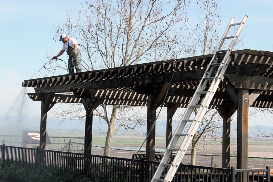

When left unfinished, redwood weathers to a soft gray patina that blends beautifully with the surroundings. However, filming of a TV production required restoration of an older, prominently situated redwood pergola and seating area just above Turn 2 to like-new condition. Full restoration required just two routine steps:
  1. Professional light power washing with water. No additives of any kind. No bleach. No detergent or TSP (trisodium phosphate) required.

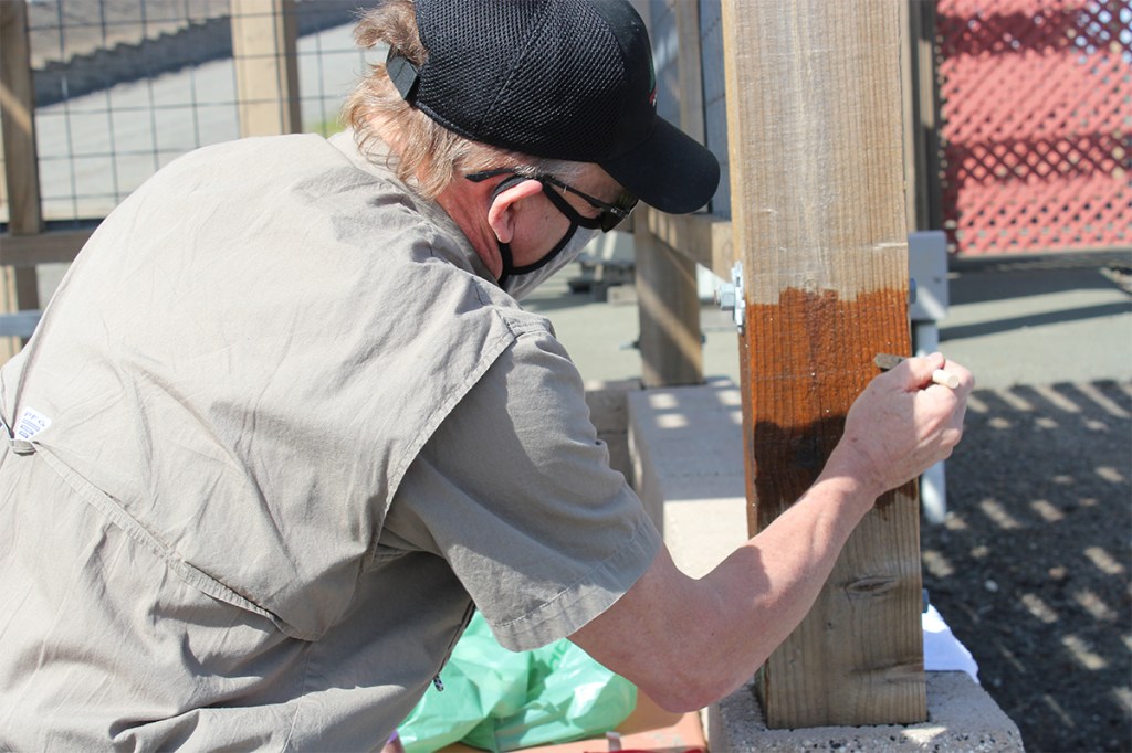

  2. After drying, hand application of an oil-based transparent stain (amber color) with brush and roller.
Bottom line: Nothing fancy, just a light professional power washing and staining.
