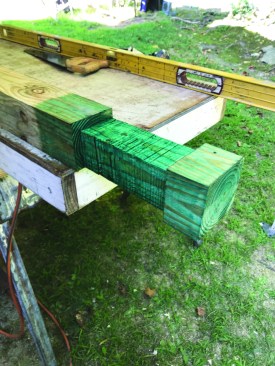

The author uses 6x6 posts, which can be notched, to support all of his deck framing.

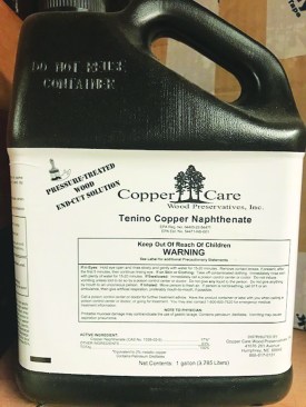

If I didn’t request that my local lumberyard carry wood preservative for treating end cuts and notches in the PT framing lumber that I (and the majority of other deck builders) use to frame decks, I doubt that they would even stock it on their shelves. That’s because they tell me that I’m one of their only customers who buys and uses the stuff.
When modifying PT deck framing, follow cutting, notching, and drilling guidelines to avoid weakening the framing.
Always treat end cuts and notches with an approved preservative to avoid compromising the wood’s rot resistance.
Sure, it takes a few moments to brush on the preservative, and it eventually ends up getting all over my hands and tools. But it’s not just a good idea; it’s a code requirement. According to the IRC, all cuts and holes made in pressure-treated wood need to be treated with a wood preservative, preferably one with a copper-naphthenate or oxine-copper (also known as copper 8 quinolinolate) base, whether the material is treated southern yellow pine or any of the incised western species.

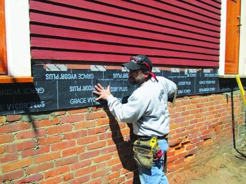

Before installing a deck ledger, the author removes the siding and protects the sheathing with a layer of peel-and-stick flashing membrane.
Another simple tactic I use to increase the longevity of my decks is to make self-adhering flashing (SAF) membranes an important part of my deck-building toolkit. For example, I always completely cover the sheathing with a flashing membrane prior to deck ledger installation, taking care to install it shingle-style with no reverse laps that can collect water.

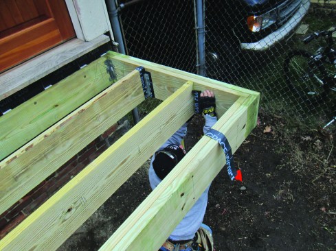

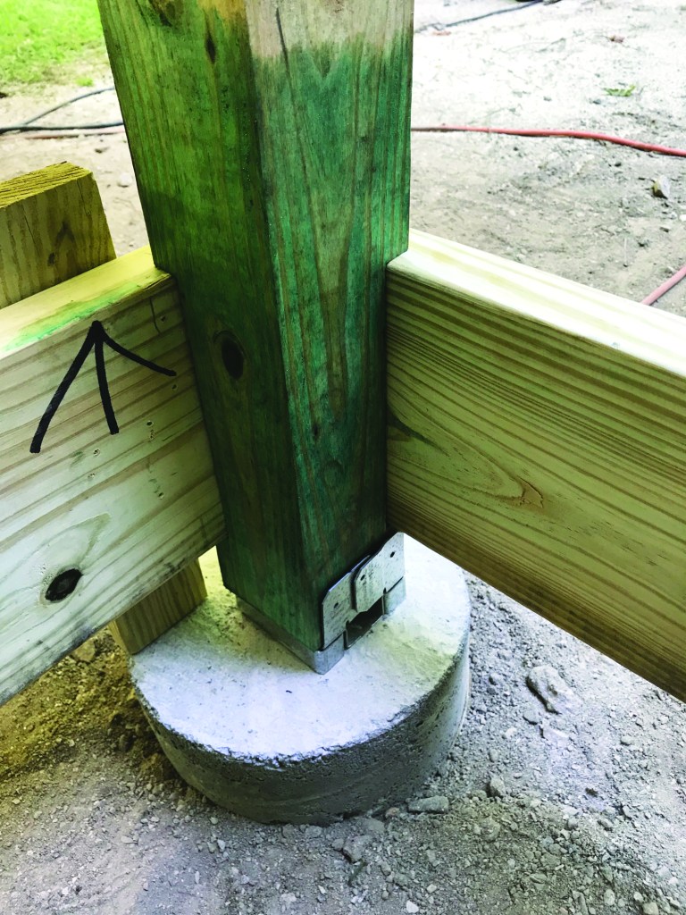

The author applies strips of flashing membrane to PT framing before installing joist hangers and other hardware.
I also use peel-and-stick flashing to separate the deck framing from any structural metal hardware. Many deck builders began using this approach when wood treaters stopped using the less reactive chromated copper arsenate (CCA) to produce their preservative-treated lumber and switched to more corrosive preservative formulas such as alkaline copper quaternary (ACQ) and copper azole (CA). These new preservatives contain two to three times as much copper as CCA in a more chemically active form, and builders began noticing that standard G-90 galvanized hardware was corroding at an accelerated—and alarming—pace.
Hardware manufacturers responded to this problem by introducing metal connectors with thicker, G-185 galvanized coatings and by expanding their stainless steel offerings, and preservative manufacturers continued to tweak their formulations and treatment levels to be less corrosive. Meanwhile, builders learned that using self-adhesive membrane as a barrier wherever metal connectors and PT framing come in contact was an effective way to minimize corrosion; I continue to use this approach today.

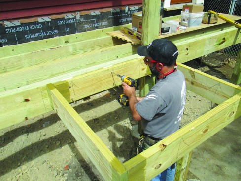

Blocking strengthens the connection between guard posts and the framing.
SAF membranes are particularly handy wherever I want to direct water away from a tricky framing detail, such as over a doubled beam or at a joist-to-post intersection.

Blocking

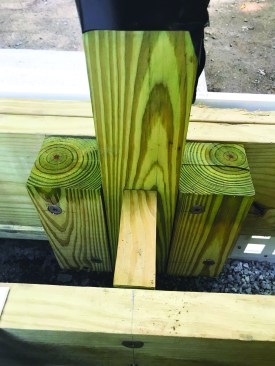

Modern decks and porches require a large amount of blocking. I use different sizes and types of PT blocking to reinforce the connections between the framing and the guard posts, configuring the blocking so that the posts will be strong enough to satisfy my inspector.
When I install the blocking with flat-headed Simpson Strong-Tie SDS screws, I predrill the holes to prevent splitting. Because these screws install flush with the framing, the heads don’t interfere with joist-hanger installation or exterior trim details, such as fascia.

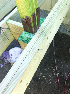

To help true up guard posts and lock them into position during installation, the author uses composite shims.
To ensure that the posts are as close to plumb as possible, I install them carefully using a spirit level and Nelson composite shims to true them up. These shims are waterproof and won’t split, crack, or compress like standard cedar shims, so the posts don’t loosen up.

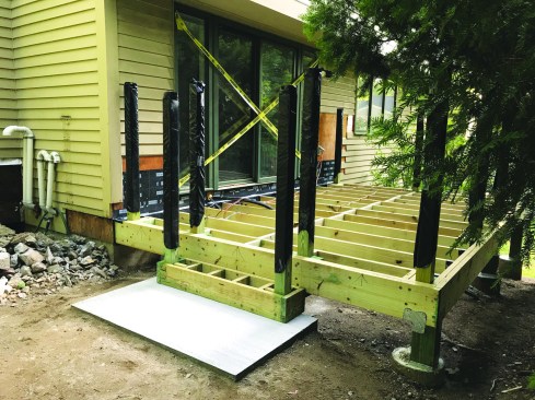

Then he wraps the posts with garbage bags, which help prevent the posts from warping and twisting by protecting them from exposure to moisture and UV rays. Taping the bags tightly around the posts helps them to last until it’s time to finish the railing system.
After post installation, I’m often not sure how long it will be until I have a chance to come back and install the composite or PVC sleeves or other details needed to complete the balustrade. To protect the posts from exposure to sunlight and rain, which can cause them to twist, warp, and curve, I like to simply wrap them with heavy-duty garbage bags, taping up the bags to prevent them from flapping in the wind and blowing away.
