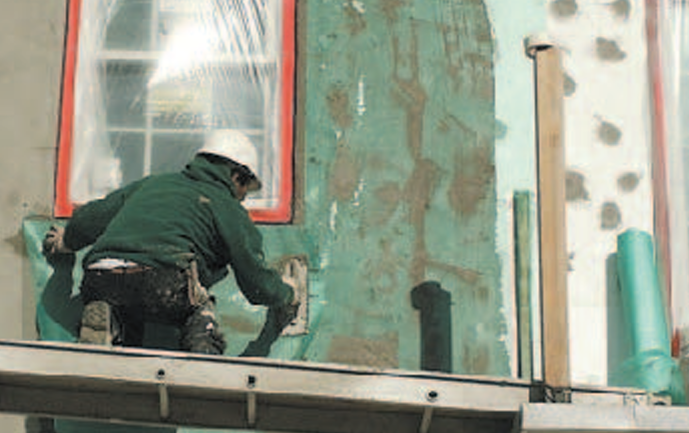

A worker trowels the mesh into the wet base coat. For good coverage, the authors recommend applying the base coat in two layers: one layer before troweling in the mesh, and a second layer immediately afterward.

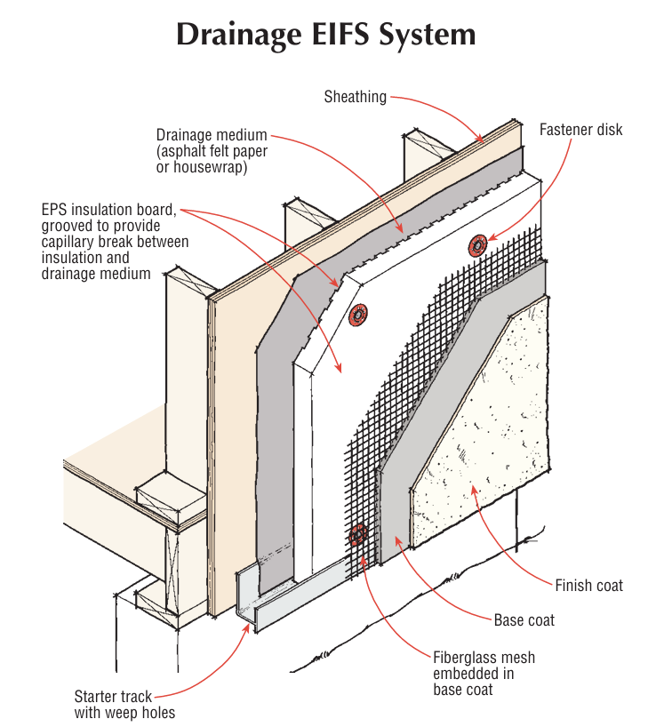

In a drainage EIFS system for wood-frame buildings, the wall is first covered with a protective water-shedding drainage plane material; then mechanical fasteners are used to attach the EPS board to the wall system (see Figure 1). This works well in buildings sheathed with plywood or OSB. (For commercial buildings that use gypsum sheathing, there are also drainage EIFS systems that rely on a liquid or troweled-on waterproofing layer and use adhesively attached EPS, but these are seldom if ever used for residential work.)
Major EIFS manufacturers that supply drainage EIFS systems all have some sort of requirement for creating an air space or capillary break between the EPS board and the drainage material covering the wall. One method is to use a “crinkle wrap” variety of housewrap such as Tyvek’s StuccoWrap. Another method is to use a type of EPS board that has a grooved, wavy, or waffled back profile, so that the board contacts the wall only in spots, creating drainage channels between the board and the weather-barrier drainage material. Both systems work acceptably.
In fact, we’ve tested EIFS systems using ordinary flat-backed EPS board over regular housewrap or asphalt felt and found that drainage occurs readily even without the “drainage channels.” If you apply the EPS board flat to the paper, apply base and finish coats in the regular way, then cut a hole in the EIFS eight or ten feet up the wall and actually pour water in, you’ll soon see the water drain out through the weep holes in the drainage track at the bottom of the wall. Water drains behind the EPS, as well as through it. It’s true that our own specs, like the major manufacturers’ specs, do call for drainage-channel EPS board or crinkled housewrap, but that is mainly because we want the warranty to hold.
The “secondary weather barrier” beneath the EIFS should include not just a water-shedding drainage material (typically asphalt felt or housewrap), but also a system of flashings for all penetrations in the envelope, including windows, doors, outside lights, dryer vents, hose bibbs, and exterior electric outlets. Transitions where exterior decks are attached or where roofs abut walls also need foolproof flashings. All the flashings have to be integrated with the water-shedding drainage plane so that water flowing downward will always go on top of the drainage material, not behind it. Before the EIFS goes on, you should be able to spray the whole building with a hose and have no water contact the framing or sheathing.
To work right, the whole drainage plane system has to be carefully considered and properly installed. We’ve created some standard flashing details that are adaptable to most situations, but it’s not possible to design a standard detail that will cover every possible scenario. In unusual cases, the trick is to “think like a raindrop.” Water on a surface will generally seek to go down, although it may travel sideways or even up when it contacts very small cracks and capillary openings. When you come to a building element that calls for a custom flashing detail, just make sure that gravity will pull the water down and away from the wall, without bringing it into contact with fine cracks or narrow openings.

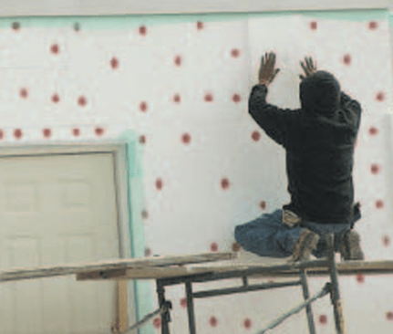

A worker attaches soft EPS “beadboard” with screws to form the base of the EIFS cladding. The close-up, below, shows the voids between the plastic beads. EPS allows water to leak through and can hold moisture against the building. That is why careful joint sealing and an effective secondary weather barrier are critical to system performance.
EPS board. EIFS requires a soft insulation board that can move without cracking. Because it must be soft, the board is not dense, and the nominal one-pound EPS board that is typically used for EIFS is not watertight. In Europe, EPS board is generally made using a vacuum process that results in a denser, less porous board. American EPS is most often made with a steam process and is generally less dense and more porous. The American manufacturing standards for a nominal one-pound-density board require an actual density of only .9 pounds per cubic foot; but in tests we have performed, most boards on the market achieve that density barely, if at all. The standards also allow the board to absorb 2.5 times its own weight in water; in effect, the foam is allowed to be a sponge.
Water can take minutes or hours to pass through EPS board, depending on the density of the board. But in any case, the EPS generally does not protect the house against water. Water that gets to the foam will trickle through it or through joints between foam pieces, and if the water can’t drain out, it will collect at low spots. Trapped moisture in the foam can create moist conditions next to the wall. So it’s critical to prevent cracking in the EIFS surface, to seal all joints effectively, to detail the secondary weather barrier carefully, and to allow drainage throughout the system.

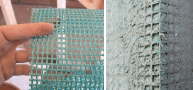

Fiberglass mesh. There are many types and grades of fiberglass mesh. It’s all made with glass fiber and an alkaline-resistant polymer coating, but the weight of the glass and the thickness of the protective coating vary. So does the way the fabric is made: Some mesh is woven, and some is non-woven.
Heavier mesh is stronger and stiffer than lighter mesh, and mesh with a thicker coating generally holds up better against the alkaline chemistry of cement compounds in the EIFS base coat. We prefer non-woven mesh because its coating is more continuous: The woven mesh can have gaps in the coating where the fibers contact each other in the weave. Unfortunately, it is difficult to find mesh manufacturers willing to fabricate non-woven mesh.
Manufacturers generally offer a “standard” 4-ounce mesh (weighing 4 ounces a square yard), which is actually their lightweight mesh. They also offer higher-weight mesh types that they describe as medium-impact, high-impact, and so on. There is also a very light 2.5- to 4-ounce “detail mesh” that is used for corners, V-joints, and the like. It’s common for installers to use the 4-ounce standard mesh in the field and use detail mesh wherever they need to bend around corners (ironically, the corners and joint areas that are most likely to crack often receive the lightest-weight mesh).
We usually recommend a minimum 6-ounce mesh. For the first floor, or at least the first 4 feet of the wall — really, in any high-traffic area where there are likely to be lawn mowers, weed trimmers, snow shoveling, and other activities that can damage the wall — we call for high-impact mesh. You can’t overlap the high-impact mesh, so you butt the pieces together, then cover the whole thing with an additional layer of the 6-ounce mesh. With that reinforcement, EIFS is almost as strong as some stucco systems, particularly a one-coat stucco.
For corners, some manufacturers provide specially formed pieces made of the heavier mesh. If you have to wrap a corner with lighter mesh, you can double it up.
Woven reinforcing mesh (top left) serves to stop the cement and acrylic base coat from cracking. A coating protects the mesh against the alkaline cement, but mesh may still be weakened by moisture and chemical attack. Exposed mesh (right) tends to lose strength over time.
The mesh strength is important, because it is the only thing keeping the surface lamina from cracking and allowing water penetration. Contractors may try to convince the owner that the 4-ounce standard mesh is sufficient, but our experience is that the 6-ounce or heavier mesh achieves better results.

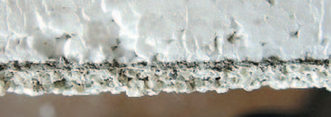

One common flaw is a base coat that is too thin and does not fully cover the mesh. In one broad survey of 80 buildings in 34 states (conducted in the 1980s), our company found that 92% of the current projects had base coats that were too thin. On projects up to three years old, only about 50% had thin base coats; and on projects between three and eight years old, about 40% had thin base coats. Basically, the more recent projects more commonly had thin base coats. Apparently, as the market became more competitive, people had stopped trying to apply the material according to the instructions. Contractors reduced the amount of material they applied in order to cut costs.
A base coat that is too thin will not properly resist water penetration or protect the reinforcing mesh. And if mesh is exposed to sun and rain, it will lose strength. Specs typically call for a base coat thickness of 1/16 inch (ours call for 3/32 inch). It’s important to enforce the thickness requirement. However, a base coat that is too thick (5/16 inch or more) has a tendency to crack because the lamina becomes too stiff.
We recommend applying the base coat in two layers: First apply a thin layer, and then partially embed the mesh in the wet coat; later apply a second layer over the partially embedded mesh and trowel it smooth. The second layer fills in the pin holes in the first layer and covers the mesh well. For an installer who is trying to do a good job — a nice smooth layer of adequate thickness — this two-step application is just about as fast as trying to get good coverage with a single layer, and you get a much better product. It’s especially important at transitions and joints, because exposed mesh and poor coverage at those points will reduce the performance of sealant joints.

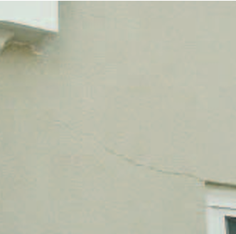

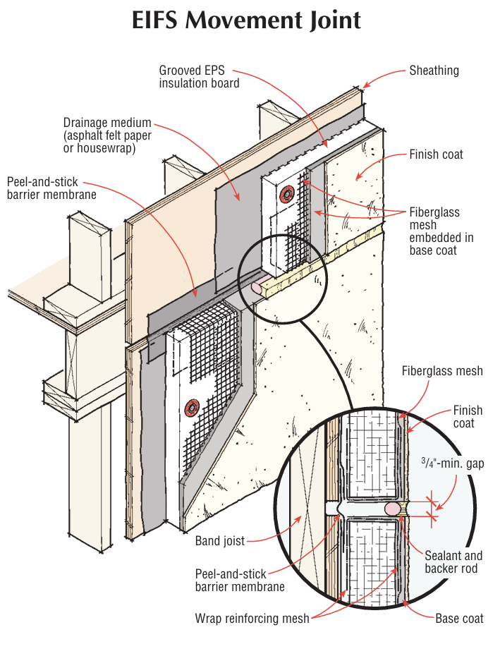

Movement joints. EIFS itself doesn’t require many movement joints. Unlike traditional stucco, which needs a joint every 10 to 15 feet to allow for thermal expansion and contraction, EIFS can have a jointless run of 50 or 75 feet, so you seldom need expansion joints on an EIFS house.
However, EIFS does need joints between floors in wood-frame construction. The EIFS itself doesn’t move, but the wall plates and band joists of wood-frame houses develop significant cross-grain shrinkage. So an EIFS house should have a joint at every floor, as shown in the illustration below, to allow the EIFS to move instead of buckling or cracking.

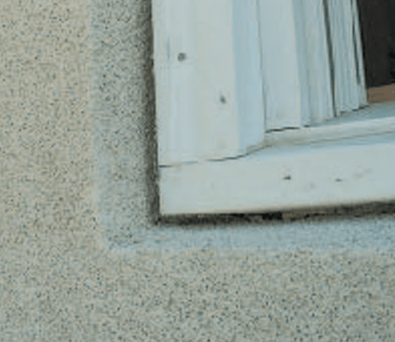

The other thing we’ve found is that when two large EIFS panels connect at a narrow point, the resulting stress concentration can cause cracking at the narrow section (see photo below). At such locations, we like to install an expansion joint to allow wall areas to move independently.
Window corners and narrow intersections between large wall sections are points of stress concentration where cracking may occur. If possible, the design should allow for isolation joints to relieve stress at such locations. In any case, the secondary weather barrier must provide protection for wall materials beneath the EIFS.

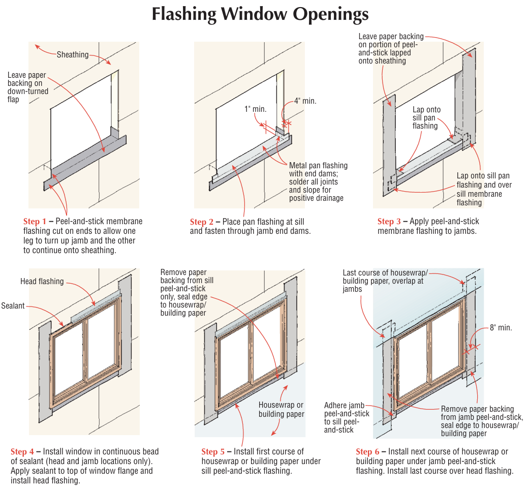

Window flashings and joints. Wherever a window, a door, or an electrical or plumbing fixture interrupts the EIFS surface, a proper joint must be constructed. Create a caulked joint at the EIFS surface; beneath the caulked joint, integrate a reliable flashing into the secondary weather barrier.
Window leaks account for the majority of water damage in EIFS houses. The EIFS itself isn’t usually leaking; instead, water is entering between the window and the EIFS, or the window itself is leaking water. The solution requires a window flashing that works, as well as a correctly detailed joint between the window and the EIFS wall.
On a lot of job sites, one subcontractor installs the windows, and another installs the EIFS. The EIFS contractor usually puts up the building paper before attaching the foam board, but he can’t flash the windows, because those get installed before he comes onto the job. So we devised a flashing detail for the window installer that allows the EIFS installer to tie the flashing into the building paper later (see details in illustration below). It uses strips of peel-and-stick flashing membrane for the bottom, sides, and top of the window, all tied into a soldered metal sill pan that is easily made to order by a metal shop. We leave the paper backing attached to the peel-and-stick at the sides and bottom of the window; that way, when the EIFS contractor attaches paper or other membrane to the building, he or she can seal the membrane over the barrier for a watertight assembly.
The EIFS is then installed over the drainage material, and the joint between window and EIFS must be sealed. Surprisingly, on many houses we investigate, none of the joints have any sealant at all. Typically, the owner didn’t want the look of the sealant, and the contractor didn’t think sealant was needed. On jobs we supervise, we explain to the owner that a well-sealed joint is a requirement to prevent a costly failure, and we detail one joint for them so they can see how it looks. Generally, once they understand the risks, they’ll agree that the appearance is acceptable for the sake of performance.

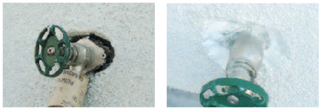

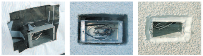

Penetrations such as hose bibbs and electrical boxes should be sealed just as thoroughly as windows, with a flashing tied into the drainage plane, as well as a surface seal where the EIFS meets the attached element (Figure 8).

All penetrations should be flashed beneath the EIFS, as well as surface-sealed at the joint. In this example, peel-and-stick membrane is used to seal the electrical box to the housewrap (left). A gap is left between the EIFS and the box (center), and the gap is then filled with backer rod and sealant (right).
Hose bibbs receive a similar treatment as the penetrations described for photos above.
