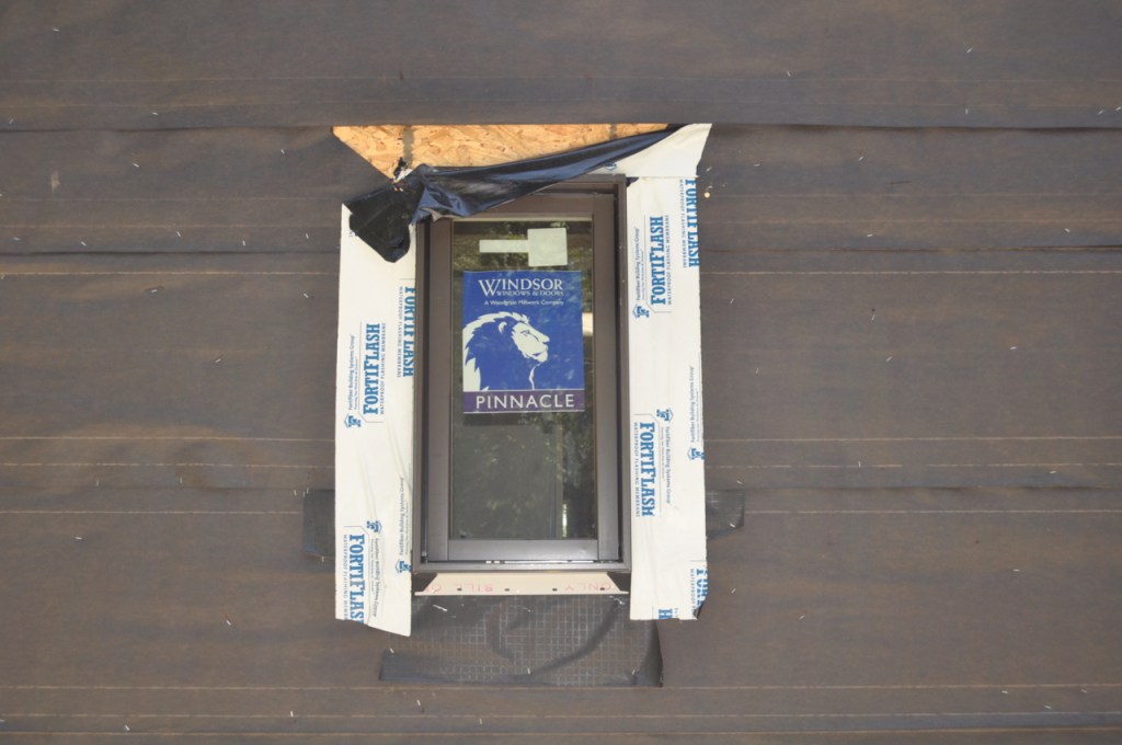

Not unusual to see a peel & stick falling off a house.  No primer used here, and it looks like it fell off the OSB quickly after application.

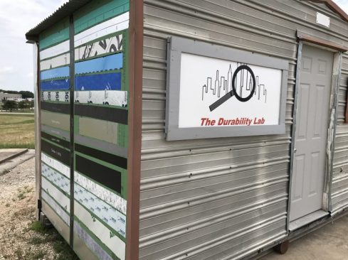

If that’s your experience, you’ll enjoy this Univeristy of Texas Construction Durability Lab study of tapes and flashings that are commonly used for weatherizing buildings. They tested a bunch of different brands of tapes and used them on several common substrates including: OSB (both sides), plywood, Huber Zip Sheathing (an enhanced OSB with a green weather resistive barrier attached to the face), exterior gypsum, and exterior rigid foam.

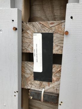

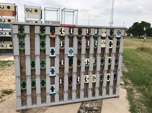

Test rack showing tapes in tension with a small weight attached to see how well they stick given stress. It’s no accident that most of these on the rack are acrylic based as the Asphaltic & Butyl based tapes have fallen off already.

Durability Test
The Durability Lab testing has a full white paper coming out this Fall but here’s my general take-aways after visiting the test facility. (Look at this link to see if the paper has been added and see the results of other testing they have done. )
  • The top tapes in the test were Dorken’s Delta Fassade S and Huber Zip tape. Both of these tapes are acrylic based and when used with a substrate that’s made for acrylic tape (i.e. Huber Zip Sheathing) these tapes did extremely well.
  • They need to be applied under the right conditions and they need a J-Roller to really hold them fast, but once they are applied well they are going to stay adhered a long time.
  • Both of these tapes were able to hold the weight without failure for the duration of the testing (roughly 30 days). Many of the other tapes failed in minutes or hours. The green WRB face on the Zip Sheathing is specifically designed as an ideal substrate for their acrylic based Zip Tape and that combo is really good!
Another big take-away from this testing is that each of these three types of tapes have their place on the jobsite, but a builder needs to know the deficiencies of each in order to know how to use them properly. For instance, asphaltic peel-and-sticks can be very useful but they take careful prep/install to work properly.
