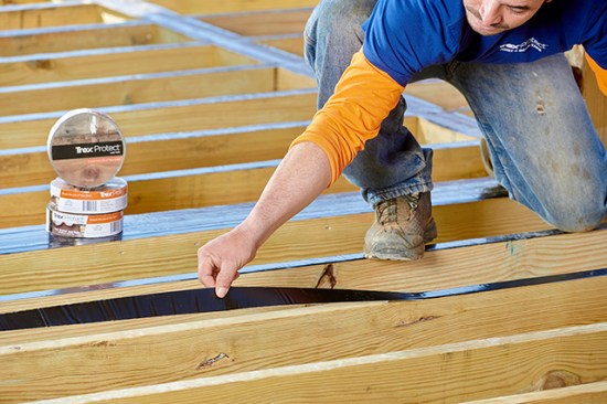

1. Deck Flashing Tape for Wood Framing

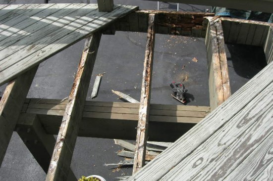

Research* shows that most wood-framed decking substructures begin to show signs of decay within the first 8-10 years. This is because wood is highly susceptible to moisture damage. Deck flashing tape is a simple and inexpensive way to protect wood from deterioration due to weather and time. It also helps screws and fasteners hold longer for enhanced structural integrity.
Without protection from moisture, wood-framed decking substructures can begin to show signs of decay within 8-10 years.
Capping joists and beams with protective tape, such as Trex® Protect™, can help to ensure the substructure lasts as long as the decking it supports.
My go-to tape is Trex® Protect™. I use it on every deck I build – no matter the size or material – because I want my work to last. Engineered specifically for use on decks, the peel-and-stick tape is applied as a cap to allow the wood to breathe. It requires minimal cuts and little overlap making application a breeze.
The butyl adhesive is super sticky creating a tight seal around fasteners. It doesn’t dry out or curl up like other construction tapes and performs extremely well in a wide range of temperatures. Trex Protect also features a non-skid surface, making it easy and safe to walk across during construction.

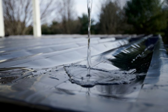

2. An Under-Deck Drainage System

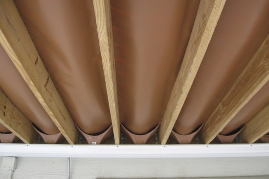

Another way to optimize a deck project is by installing an under-deck drainage system. Using a network of troughs and downspouts, these systems divert water away from a deck, preserving the studwork and also keeping the area underneath dry and useable for storage or as additional living space – something all homeowners seem to be seeking these days.
For optimal protection and aesthetics, I use Trex® RainEscape®. Installed above the joists, this system protects the entire foundation and also allows homeowners to run electrical wiring for lighting, ceiling fans and entertainment components, as well as gas lines for grills and outdoor kitchens – all concealed between the deck surface and a soffit ceiling to create a finished look.
Trex RainEscape is easy and efficient to install. The entire system includes just five SKUs and only a utility knife, staple gun, hammer and caulk gun are needed for installation. The process takes no more than a few hours to complete, and the system is backed by a 20-year warranty from the world’s #1 decking brand.
Using a series of troughs, funnels and downspouts, Trex® RainEscape® installs above the joists to keep everything beneath a deck dry and protected.
Rubberized membrane pieces are stapled to the top of the joists and shaped to hang lower at one end of the joist bay to facilitate drainage.

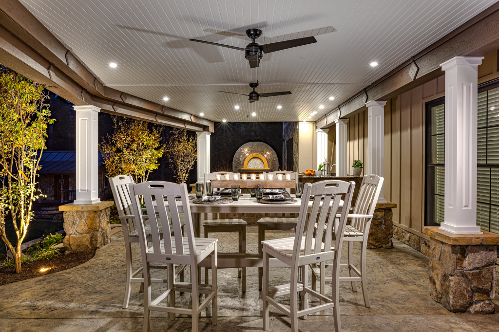

Another “bright” idea for adding value to a deck project is lighting. Dimmable LED lights incorporated into railing post caps and stairs can increase safety while enhancing ambiance and extending the time that homeowners can spend outdoors. And don’t forget to illuminate the space beneath the deck with soffit lights.
Trex® RainEscape® Soffit Lights install easily to enhance the ambience and function of an under-deck living space.
