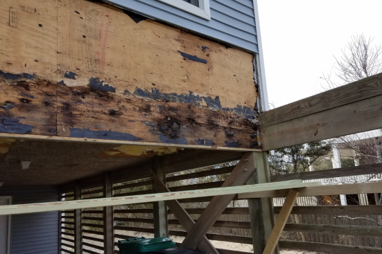

4. Neglecting to Waterproof
Easily one of wood’s worst enemies, moisture is a recurring theme across ledger board failures. In most deck installations, there is a gap left between the house and the deck that allows water to seep down onto the ledger board where it can penetrate the wood and lead to decay. This is why it’s critical to protect the ledger with waterproof flashing.

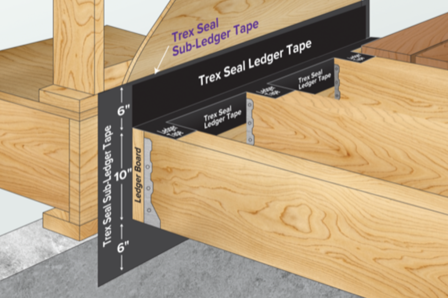

While there are several types of flashing available, only tapes have the ability to create a waterproof seal. These self-adhered membranes also eliminate the need for fasteners that create holes, and they won’t corrode.

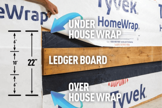

Trex Seal represents a new generation of waterproofing membrane that combines the best performance features of metal and tape flashing. This aluminum-lined tape comes in sizes to protect the entirety of the ledger board. An 11”-wide tape provides complete coverage of the ledger board face and also seals any gaps between the ledger and the substructure. A 22” sub-ledger tape creates a continuous water-tight seal between the ledger and the housewrap to prevent water from infiltrating the house. Both products feature convenient release liners for easy and accurate application and are Code AAMA711 compliant. These extra layers protect the ledger board on all sides significantly reducing the likelihood of wood decay and increasing the lifespan of a deck.
