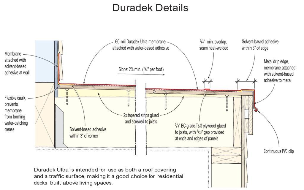

Although the PVC membrane itself can be installed only by an authorized Duradek dealer, we needed to construct the deck properly to receive it. For proper drainage, the manufacturer requires a deck slope of 2 percent, or 1/4 inch every 12 inches. For our 6-foot-wide deck, we pitched the roof 11/2 inches by ripping tapered wedges from framing lumber and gluing and nailing the wedges to the ceiling joists.
After bolting the 4×4 rail posts in place, we installed 3/4-inch T&G plywood, per the manufacturer’s recommendations, gluing the plywood to the joists and leaving the proper gap at the ends and edges of panels. Because of compatibility problems between the PVC membrane and the compounds used with treated plywood and polymer-enhanced OSB underlayments like AdvanTech, those sheet goods aren’t recommended.
We next installed the fascia boards, then covered the deck with 15-pound felt paper and installed temporary flashing at the deck-wall intersection to keep the plywood dry until the Duradek sub arrived approximately three weeks later. The manufacturer recommends that the decking be at no more than 12 percent to 14 percent moisture content at the time of installation. In hindsight, getting estimates earlier in the process would have tightened the schedule.

The two installers started by nailing a galvanized metal drip edge around the outside perimeter. Duradek offers several edge-finishing options; the one used here is designed so that the membrane laps over the metal and is secured with continuous PVC clips that slip over the metal’s flared edge.
Next, the installers filled the plywood joints, voids, knots, and low areas with a patching compound they mixed up on site. Duradek — like vinyl — will telegraph even small imperfections in the deck sheathing, so they inspected carefully as they smoothed the compound with their sanders. After filling the joint where the terrace plywood deck meets the second floor walls with a flexible caulk, they carefully swept and vacuumed again.

Planning for seams. Because the deck was slightly wider than the membrane, there would have to be one seam; it fell under the railing where it was barely visible. The 9-inch-wide strip of membrane that finishes the deck is overlapped by the first piece and folds down over the drip edge.
Duradek seams are heat-welded rather than glued together, and require a minimum 3/4-inch overlap. Making these seams properly is the most critical part of the installation: The weld will fail if any of the adhesive used to fasten the membrane to the deck contaminates the seam.
Installing the Membrane
After dry-fitting the full-width piece, the installers pulled the material back away from the wall and folded it in half lengthwise onto itself. They then spread the water-based Duradek adhesive on the exposed plywood and folded the first half of the membrane back into place, taking care to eliminate air pockets as they smoothed out the material and pressed it into the adhesive.
Once the first half of the Duradek was glued down, the installers carefully cut openings for the four railing posts, marked the position of the outside edge of the unglued half of the membrane, and then folded this half back over the glued section. Next, they glued down the narrow outside strip of membrane, then glued down the second half of the large piece. They used heat guns to heat the overlap, blowing hot air into the seam and then pressing the two halves together with a roller. Every few feet, they checked the seam strength.

At the new doorway into the master bedroom, the membrane wraps up and over the rough sill. To make this critical area watertight, all of the joints were welded. After the membrane was in place, we installed the new door, which sits on top of this waterproof pan.
In other areas where the membrane folds up onto a wall, the installers used Duradek’s solvent-based adhesive, which is applied like contact cement to both surfaces. Later, we patched in the housewrap and shingles, lapping them over the membrane.
Around the perimeter of the deck, the membrane folds down over the drip edge. The installers heat-welded the corner seams and fused the overlapping membrane to the metal. After trimming the edge of the membrane flush with the bottom of the metal, they finished the bottom edge with continuous PVC clips.
