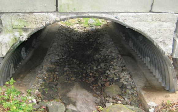

Massachusetts has strict stream-crossing guidelines, and we had only two practical options. The first was to install an open-bottom arch culvert, which would not disturb the streambed. These arches are typically manufactured off-site and installed on a poured concrete foundation. The approach ramps are usually retained with precast concrete blocks stacked to form walls.
One drawback of this approach is that it’s difficult to neatly transition these rectangular blocks into the semicircular culvert. The resulting industrial look did not appeal to me.
Another problem is that the cost of the arch rises dramatically as the span increases. The narrowest crossing point available was 28 feet wide, meaning that this span would push the economic limits. To be at all cost-effective, the foundation would have to be flush with the wetland boundary, and this would increase the chance of damage to the wetlands.

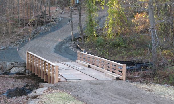

A better option. I encountered the second approach while searching on the Internet, where I learned of a Colorado company called Paragon Bridge Works (970/737-1174, prsx.com), which converts retired railroad flat cars into vehicular bridges. I liked the way the sample bridges looked, and thought that such a bridge would be an added selling feature for my project.
Another benefit of the rail-car bridge was its ability to handle the span with ease. This was a key feature for my site, because it allowed me to cross the stream at a location that lined up with the existing farm road. At about 32 feet, the wetlands were too wide for the arch culvert at this location and would have required a costly and time-consuming wetlands fill and replication. The longer rail-car span also enabled me to set the bridge foundation further from the wetland boundary, minimizing the chance of disturbance to the conservation area and speeding the approval process.
I estimated the overall cost of the arch-culvert bridge and the rough driveway leading up to it to be $57,000. The cost for the rail-car bridge added about $10,000, but the aesthetic and technical advantages made me decide that this was the way to go.

Once the crossing method was established, I worked with a civil engineer and Paragon Bridge Works to design a bridge that had the details I wanted and also met fire department and zoning requirements. I paid Paragon to strip and paint the bridge and to weld on brackets for mounting the bridge rail. I also purchased wood for the deck and rail from the company, because the brown pressure-treated wood they were offering was much better looking than the green-colored product available in my area at the time.

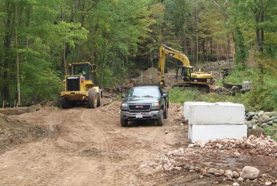

After placing the order for the bridge, I installed erosion controls, had them inspected by the local conservation commission, then began clearing trees and removing stumps. We were almost done with the tree clearing when Hurricane Hanna dumped 7-1/2 inches of rain on the area over the course of two days. The erosion controls passed the test, dispersing this huge amount of rain and preventing damage to the stream environment.

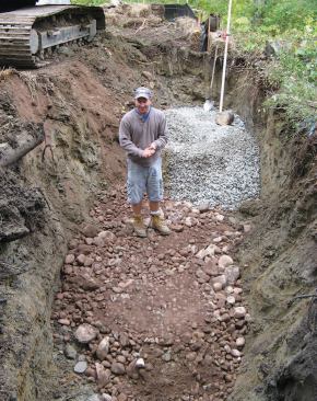

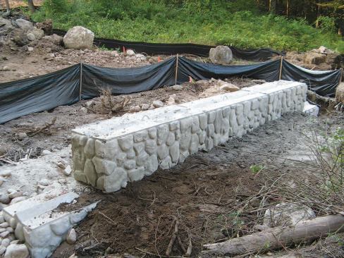

With the trees and stumps out of the way, we graded the rough driveway up to the bridge and excavated the trenches for the abutments. Thanks to an existing culvert on the farm road, we were able to reach the far side of the stream without arranging for a temporary bridge or other access.

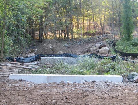

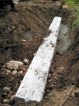

Getting the abutments level and square is critical, so we took extra care with this part of the job. The interlocking precast concrete blocks used as abutments for the bridge were formed from waste concrete by a concrete plant in town. The blocks were set in three courses, with the bottom course set on a stone base below the frost line. We used plain block for the buried courses, but specified a decorative cast-stone pattern for the face of the above-grade course. The whole process of installing the abutments took about one day per side.
