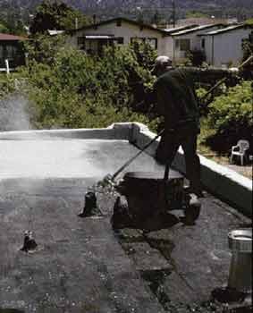

After the base sheet is down, we install flashings. The project pictured in this article was a reroof, so we had to replace the flashings around vent pipes and at the scuppers. If there hadn't been a parapet, we would have installed gravel stop flashings at the edge. Flashings come in aluminum or galvanized steel; either type works on a hot-mop roof.
We bed the flashings in plastic roof cement, nail them to the sheathing, and prime them with a spray-on or brush-on asphalt primer. With torch-down, it's standard procedure to lay up the entire roof, then patch in around scuppers and plumbing vents. It's possible to do this with hot-mop, too, but installing the flashings before the asphalt and felts are applied leaves fewer seams.

Melting. Most contractors have never been up on the roof while BUR was being installed, but everyone has seen the kettle on the ground, which is built onto a trailer and uses propane to melt the asphalt. My kettle holds up to 350 gallons and is equipped with a pump that moves asphalt to the roof through steel pipes. The asphalt we use comes in 100-pound cylindrical plugs; we break the plugs into smaller pieces with an axe and put them in the kettle to melt.
It's important to maintain the proper temperature when melting and applying asphalt. If the kettle is too hot, the asphalt could catch fire or be degraded by overheating. If that happens, it won't perform properly.
We frequently use Trumbull's type 3 asphalt, which is designed to be applied to the roof at 410°F, plus or minus 25°F. At this temperature, it has the correct viscosity to properly bond the felts. If the asphalt is too hot, it goes on too thin. If it's too cool, it will go on too thick and will not fully bond the felts, producing a membrane prone to cracking. Of course, the kettle must be hotter than the application temperature because the asphalt will cool on its way to the roof.
Once the hot asphalt gets to the roof, we transfer it to buckets or wheeled carts and haul it to the area where we're working. Hot asphalt can give you a really nasty burn, so whenever we move it we yell "Hot!" to alert everyone around to be on guard. It's a bad idea to work below a hot-mop roofing crew: If a bucket is tipped, hot asphalt could slosh over a skylight curb or pour off the edge of the roof.
