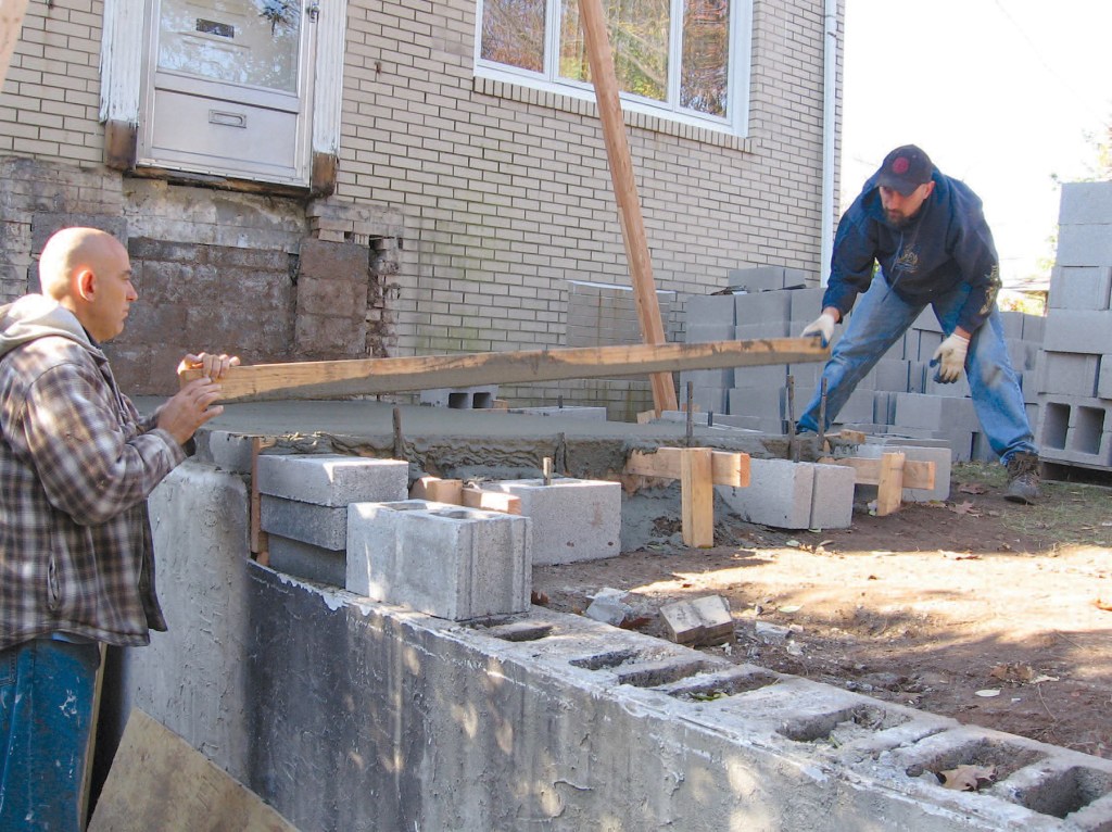

Setting Block
As with concrete, mortar sets up best in humid climates with temperatures averaging above 40°F and below 70°F. In climate conditions above and below this, follow similar procedures described in Hot-Weather Concrete and Cold-Weather Concrete.

Block Construction Details
If you have control over design decisions, lay out the distances between corners and bump-outs, as well as the dimensions of door and window openings, in increments of 8- or 16-in. to match full- and half-block lengths.
Running Bond
Concrete blocks are designed to be laid in a running bond (sometimes called half-bond) pattern in which the vertical joint of two adjoining blocks falls over the center of the block below (Figure D).
Cut Block Placement
If blocks must be cut, maintain a running bond by staggering cut blocks symmetrically (Figure E). Joints can be as close as 4 in. from a joint in the courses above and below and not affect the strength of the wall; but the appearance will suffer if the joints are off-center. Where portions of the wall will have cores filled with concrete, keep the half-bond dead accurate.
Building Block Corners
Corners are a key detail in a block basement, and must be built to maintain a modular layout. With 8-in. block, weaving block at corners establishes the 8-in. running bond and keeps the cores in two-core block in line (Figure F). For 10- and 12-in. block, a number of techniques can be used to lay out corners (Figures G and F); the simplest method uses special corner block.
