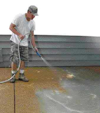

Aggregate is present in every concrete slab, but because it’s encased in a matrix of sand and cement it’s not usually visible. Removing the top layer of sand and cement to expose some of the aggregate makes the surface of the concrete look a lot better, and the process is not much more expensive than plain gray flatwork.

Size. Some contractors like to use normal size (3/4-inch to 1 1/2-inch) stone when doing an exposed aggregate finish. I don’t like doing this because if the concrete is a little too wet, you can end up with areas where there is visibly more cement than aggregate. This can happen anytime you place concrete, but it’s noticeable with an aggregate finish.
We prefer to use a smaller size stone. Our local brown river stone is available as regular size aggregate or as a smaller size called Meramec torpedo. They’re the same type of stone but the torpedo has been passed through a finer screen. It’s small and very consistent in size, so it produces a smooth, uniform surface.
The mix. Concrete contains water, portland cement, graded aggregate, and sand. Technically, the sand is just a finer type of aggregate. The cement, water, and sand form a paste that fills voids and binds the aggregate together. Around here, most contractors use a four- to five-sack mix (four to five 90-pound bags of cement per yard of concrete) for residential flatwork. When we do an aggregate finish, we use a six- to six-and-a-half-sack mix and a little less sand. Reducing the sand makes the pebbles stand out more on the surface, while the extra cement makes for a stronger slab.
