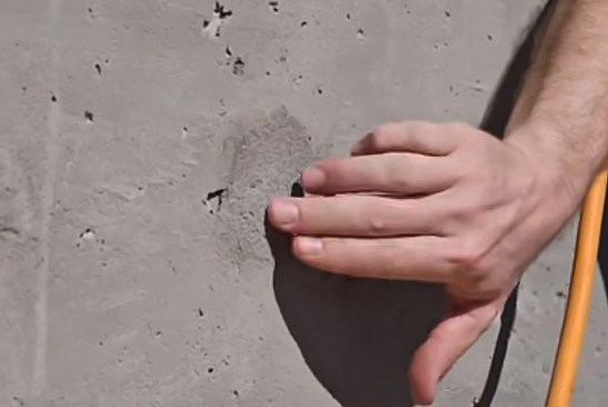

The first step in applying this material is to inspect the surface of the walls and fill any large voids with mortar.
Liquid-applied membrane. Newer-generation liquid-applied materials that use SBR (styrene-butadiene rubber) are specifically designed for waterproofing concrete. They function as true waterproofing because they are completely insoluble in water and can resist hydrostatic pressure (although we do want to limit this pressure, as I’ll explain further on). The material is spray-applied as a liquid, so it goes on as a continuous, monolithic membrane. At critical areas—transitions between the footer and the foundation wall, inside corners, or pipe penetrations—a liquid material perfectly conforms to surface variations without a lot of fancy origami.

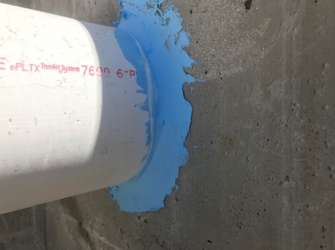

All through-wall penetrations are critical.

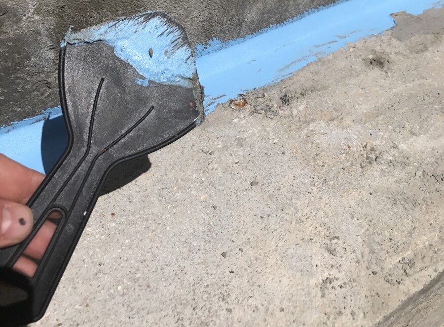

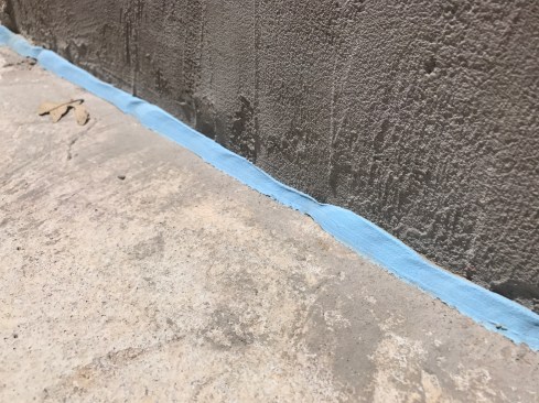

The cold joint between the footing and the wall needs a heavy bead of
sealant, such as Poly Wall’s 2200.
The cold joint between the footing and the wall needs a heavy bead of sealant, such as Poly Wall’s 2200.
There are a number of waterproofing products formulated for concrete walls. A builder friend of mine, Brian Long, swears by Poly Wall’s Home Stretch Liquid, a synthetic rubber product that has been used in the commercial market for more than two decades but has only recently been introduced to the residential market.
The sealant should be tooled to ensure good adhesion and complete coverage.
The first step in applying this material is to inspect the surface of the walls and fill any large voids with mortar. Smaller voids are OK; the rubber will fill them. But larger imperfections will fill unevenly and create a weak spot in the monolithic surface.
All through-wall penetrations and the cold joint between the footing and the wall are critical areas that need a heavy bead of sealant, such as Poly Wall’s 2200 sealant, first. The sealant should be tooled to ensure good adhesion and complete coverage.

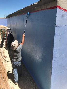

Brian Long likes to spray a liquid applied membrane on the wall.
He has a crew member follow with a roller to even out the laps.

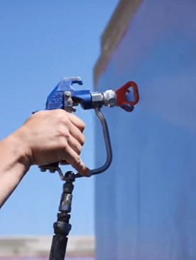

You can roll on a liquid-applied membrane, but Brian Long likes to spray it on the wall. Spraying is faster and makes it easier to control the thickness. He has a crew member follow with a roller to even out the laps.

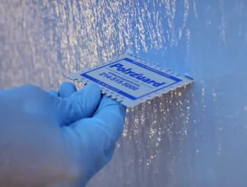

The material is sprayed on to a 60-mil thickness, which dries to a 30-mil, one-piece, no-seam finish.
The material is sprayed on to a 60-mil thickness, which dries to a 30-mil, one-piece, no-seam finish. The crew uses a hydraulic Graco 733 sprayer and periodically checks the thickness as they work. One nice thing with the sprayers: You can leave material in the machine for up to two weeks, which gives you the ability to return to a single job on multiple days without a lot of heavy clean-up.

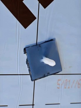

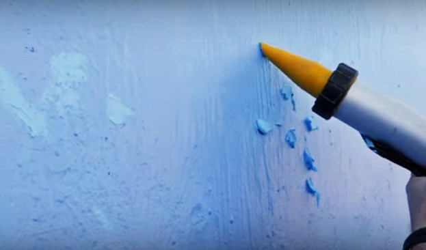

The crew uses 2200 sealant to fill in any holes or places with incomplete coverage.
After the membrane is applied, Long’s crew checks the surface of the membrane and deals with any imperfections, using the 2200 sealant to fill in any holes, pock mocks, or places there isn’t complete coverage. This step may seem incredibly picky. But again, compared with dealing with an unhappy client, it is time well-spent.

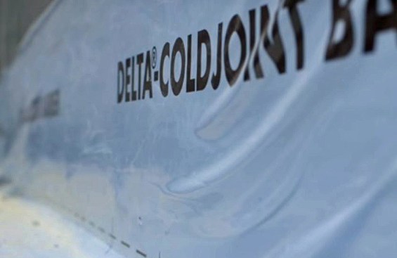

ColdJoint Barrier is applied to the horizontal ledge of the footing and up the wall for about a foot.

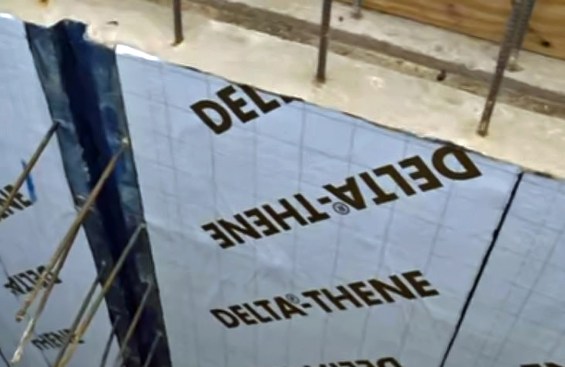

It is overlapped by Delta-Thene, a 40-mil-thick peel-and-stick wall membrane that’s about 3 feet wide.

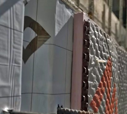

Peel-and-stick membranes offer an excellent waterproofing alternative. For best results, I start with a 40-mil-thick membrane applied to the horizontal ledge of the footing and up the wall for about a foot to protect that critical footing joint. The vertical leg of this cold-joint barrier should be overlapped by a 40-mil-thick peel-and-stick product that’s about 3 feet wide. We typically run the membrane vertically. Most peel-and-stick products made to be applied over concrete require a primer. Once the primer is rolled on, we pull the backing off the membrane to apply it, creating an adhesive-to-adhesive bond that holds tenaciously.
Over the waterproofing membrane, we add an insulation layer. Here in Austin, we need only one inch of foam; in northern regions you’d need more, of course. We’ve had good luck with plastic stab anchors for installing the insulation. The anchors have a peel-and-stick adhesive that bonds to the surface of the wall membrane. With these in place, all we have to do is push the insulation on to hold it in place. We can use the same anchors to install the drainage mat. Most important is that we end up with no penetrations through the waterproofing membrane.

After applying a waterproofing to the foundation, a lot of builders think the job is done and move directly to backfilling. But by doing so, you are allowing water to back up directly against the membrane, where it might find an imperfection and create a leak.
The ideal way to solve this is to put a drain board over the membrane. The primary purpose of this drain board is to provide an air gap so that water running towards the foundation hits that gap and flows down to the footing drains. Think of the gap as a pressure relief valve. If there is an open gap, water pressure can’t easily build up against the foundation.
Secondarily, the drain board protects the waterproofing membrane against rocks or road base or whatever you are using as a backfill material.
The drain boards run vertically and are installed over the insulation using the same stab anchors.

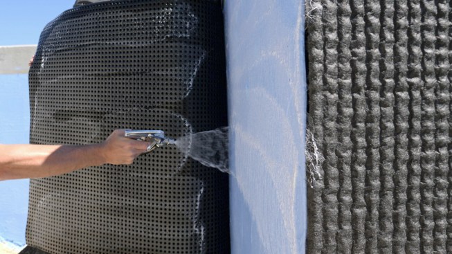

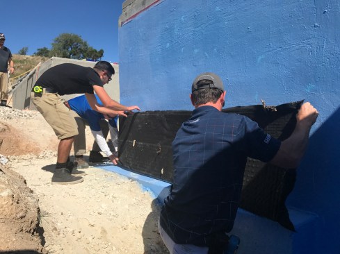

I’ve used Delta-Drain, a dimple mat from Cosella-Dorken. Like most drain boards, it’s covered with a filter fabric that keeps soil from clogging the gap. The boards run vertically and are installed over the insulation using the same stab anchors mentioned above.
Poly Wall’s Arroyo drain board works well, too. It comes with a unique layout of dimples, with larger ones at the bottom of a 2-foot-wide starter course, and smaller dimples at the top of the section that mesh with the dimples of the next, 4-foot-wide course.

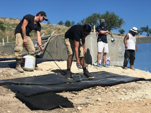

The boards are installed using a spray contact adhesive applied to the back and to the wall.
The adhesive is allowed to flash off. Then the drain board is applied to the wall.
Long’s crew installs the Arroyo product using a spray contact adhesive that they apply to the board’s back and to the wall. They allow the adhesive to flash off, the way you would with a countertop adhesive, and then apply the board to the wall. It sticks tenaciously, and there’s no need for fasteners that would make penetrations through the water barrier. At corners, the crew scores the back to break cleanly and fold over the corner. You don’t want to cut the filter fabric anywhere. The fabric at edges runs long so you can stretch it over the course above or around a corner. You want to maintain an unbroken, uniform fabric surface to keep any sediment from getting in and clogging the spaces created by the dimples.
The crew scores the back to break cleanly and fold over the corner.
Arroyo drain boards run horizontally, so you can install them in lifts, backfilling as you go. This makes it easier on the crew, because they do not need to reach up the entire height of a tall wall.

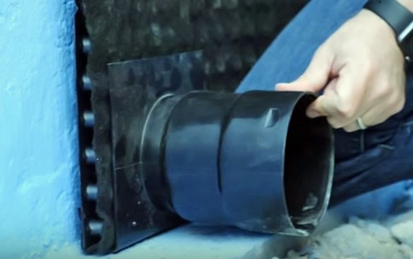

The Arroyo system offers an outlet system that works if you are not using a traditional French drain.
The Arroyo system offers an outlet system that works if you are not using a traditional French drain. The outlets tie right into the drain board and allow you to tie in a solid pipe to drain water out directly from the boards.

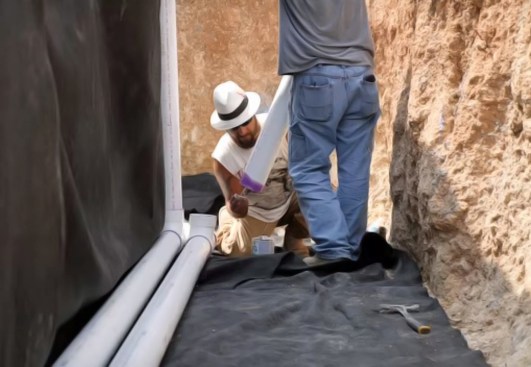

Drain Out

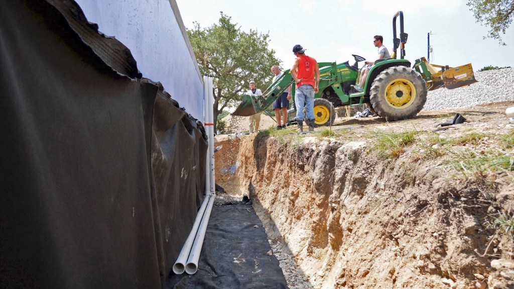

Any foundation waterproofing system that protects the foundation from water and relieves hydrostatic pressure needs a third critical component: a way to drain out. We always install a traditional French drain system—a standard that Americans have been using for generations on houses. This consists of a drain pipe that is run in a bed of rock. We typically use 4-inch Schedule 40. We have found that Schedule 20 can collapse (and the corrugated black pipe seems essentially worthless), so it’s worth going with the thicker-walled PVC pipe. The holes are predrilled and always face downward. The perimeter pipe is covered with a coarse gravel or septic rock that must be separated from the surrounding soil with filter fabric to prevent soil from clogging the rock.
The French drain uses two pipes, each with a clean out installed at every corner.
A conventional footing drain uses a single pipe around the perimeter and a filter sock, but the sock limits the volume of stone that you can install to provide drainage.
Long takes the French drain to whole new level, using two pipes each with a clean out that he installs at every corner. If a problem ever occurs with the drain system, it will be easy to run a snake down to free up a clog.

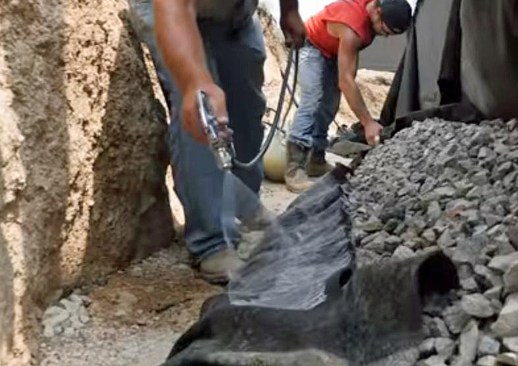

Spray adhesive is applied along one edge of the filter fabric.
The fabric is pulled over the rock, adhering the edge to the fabric draped up the wall.

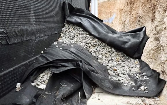

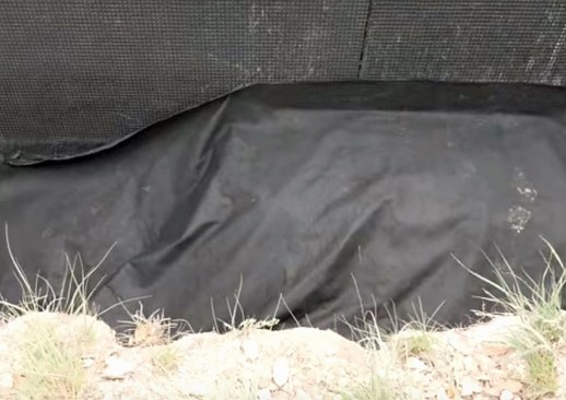

Around the perimeter of the footing, Long pours gravel over the twin drain pipes into what he calls a “drainage burrito,” starting with a wide piece of filter fabric running up the wall and onto the bottom of the excavation. He lays in the drain pipes and covers them with a healthy amount of septic rock. He then applies spray adhesive along one edge of the filter fabric and pulls the fabric over the rock, adhering the edge to the fabric draped up the wall. On top of this, he comes in with another layer of filter fabric and then covers that with another layer of filter fabric. This double layer of rock and fabric ensures that he doesn’t allow any sediment inside the drain; the house shown in the photos is in a part of Texas that has a fine caliche that is adept at finding its way inside a drain, so Long needed to be meticulous about how he detailed the fabric.
On top of this, another layer of filter fabric is layered. That is covered by yet another layer of fabric.
