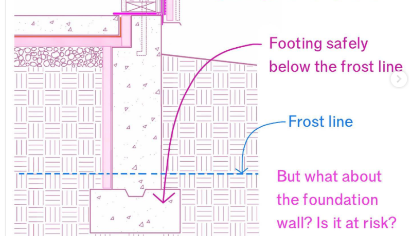

This Building Science Fight Club post is a great example. Most of us in cold country know a little about frost heave and getting the footing below frost depth, but maybe we weren’t clear on exactly how the ground freezes and where the heat flows. Understanding these concepts better makes it much easier to decipher how to detail a shallow foundation and where to place the insulation.
