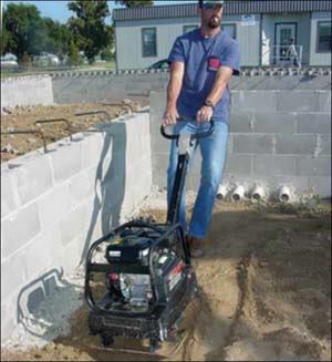

In the flood-prone Gulf region, an elevated home is a no-brainer. But damp conditions and termites are an everyday fact of life that can makes for one ugly crawlspace. The solution? Fill the crawlspace with drainable, compacted soils and cap it with a slab.

“For an elevated slab,” Lstiburek explains, “you do a block foundation or a poured stem wall, you fill the whole thing with fill material, and then I like to put a topping slab, a cap slab, on the top — and that locks everything together.” (See Figure 1.) It’s typical in South Florida to build one-story houses and the first story of two-story houses using concrete masonry units (CMUs). “We put an inch-and-a-half seat in the perimeter of the cap slab, as a seat for the block wall,” says Lstiburek. “So we have our stem wall, then a cap slab, and then another block wall on top of the slab — and then we insulate on the inside of the block wall. I think that’s a real nice way of raising the slab.”
