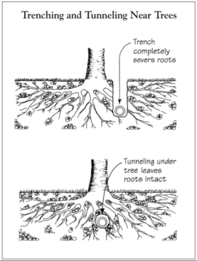

Digging a trench near a tree is often the most damaging site work of all, since it severs all the roots that intersect the trench (see “Trenching and Tunneling Near Trees,” below). How much injury trenching causes depends on the depth of the trench and its distance from the tree. Obviously, a trench right next to the trunk will do a lot more damage than a trench out near the drip line.
Digging a trench near a tree will completely sever the roots, especially if the trench runs close by the trunk (top). For a tree that increases real estate value, it might be worth the time and effort to tunnel under tree roots (above).
There are two ways to avoid damage from trenching: Relocate the trench, or tunnel under tree roots. Keep in mind that the extra cost of a longer trench or tunneling will usually be recovered through the direct economic value of the trees you save, either in reduced landscaping costs or resale value of the house. If your usual approach for a buried electric or gas line, for example, is to keep the run as short as possible to save money in materials and trenching, consider digging the trench around valuable trees. Tunneling under tree roots is more difficult and time consuming,but you can use a power soil auger to speed things up.
When roots are accidentally severed during trenching or tunneling, cut the ends cleanly with a saw or clippers. Then refill the trench as soon as possible to keep the surrounding soil from drying out and further damaging the remaining roots.
