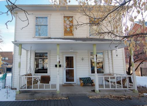

Back at the turn of the 20th century, miners flocked to the new town of Louisville, Colo., to work in its emerging coal industry. There must have been some skilled carpenters among them, because the town is filled with beautiful Victorian-era homes. Unfortunately, they built the foundations the same way they built coal mines, driving wood pilings into the ground and framing right on top of them. Over the years, those old wood foundations have failed and been replaced with a hodgepodge of stone, concrete, and block, none of which is particularly well-suited for the area’s expansive clay soils.

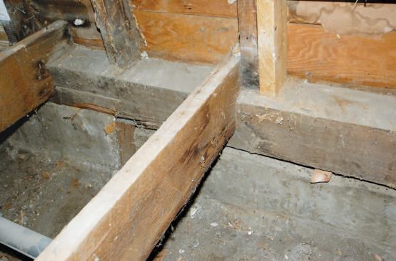

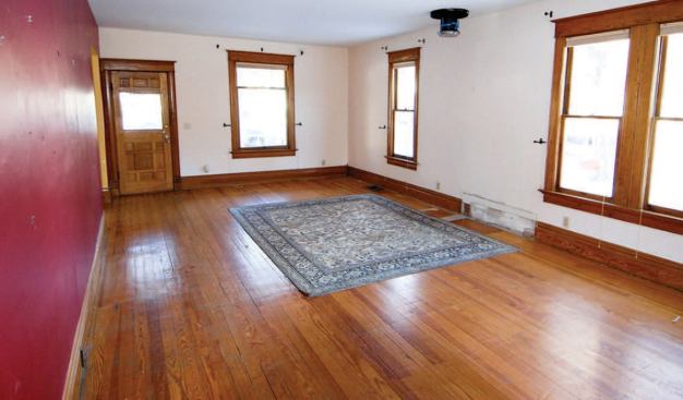

Such was the history of my clients’ house: The shallow spread-footing foundation that replaced the original perimeter pilings had settled over the years, causing the wood floors of the foursquare home to sag, buckle, and splinter.

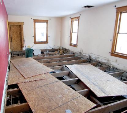

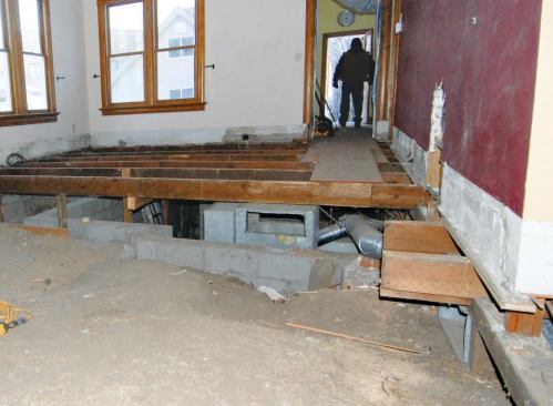

Our goal was to stabilize the foundation and flatten the floor, but not necessarily to level the house, since jacking the walls could damage the home’s old plaster finishes. My clients briefly considered raising the house and adding a full basement, but decided they didn’t need the additional space. A previously built basement-level masonry-block mechanical space would remain.

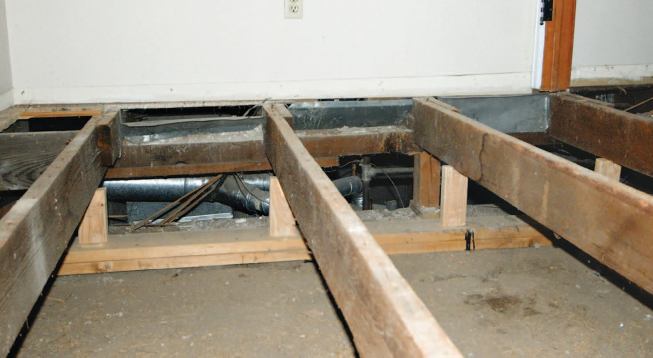

We started by removing as much of the floor system as we could while leaving the perimeter walls and existing foundation intact (see slideshow). There was no subfloor, so we stripped the wood flooring and began removing individual joists. The walls were balloon-framed, which simplified the process of removing the joists along the exterior walls. We left short sections of the joists in place under the center bearing wall, which we temporarily shored. Then we called in the helical pier contractor.
