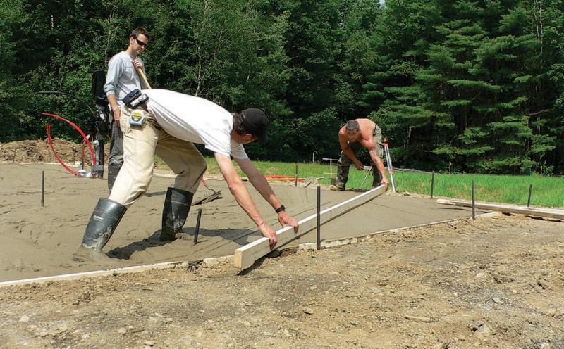

Level Base
The subbase must be graded to the same level across the full width of the slab. Level the subbase to within 1/2 in. (less than 12.4% of a 4-in. slab). Where subgrade elevation is inconsistent, the slab will vary in thickness. This variation will cause it to cure unevenly, which will stress the concrete, increasing the likelihood of cracking.

Control joints can be tooled in the slab surface with a grooving trowel or cut with an abrasive or diamond circular-saw blade at recommended spacing and depths (Figure I). Make tooled joints during finishing, as soon as bleed water has evaporated. Cut sawn joints as soon as possible after finishing the slab. Random cracks may appear as rapidly as within six hours in hot weather.

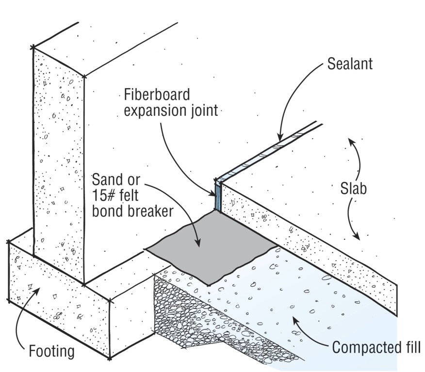

Isolation Joints
Provide isolation, or expansion, joints at garage and basement slab edges (Figure J) and at column footings (Figure K). This prevents movement of one element from damaging the other. Expansion joints can be made of asphalt-impregnated fiberboard or a plastic strip that can be zipped off after concrete is placed.
For a finished appearance in slabs, score fiberboard expansion material prior to placing, so it can be snapped out and the joint sealed with caulk (Figure L). This same detail should be employed with exterior driveway expansion joints; in this case, the caulk provides an important protection from potential freeze-thaw damage (see Concrete Drives).
Basement slabs must also be isolated from the footing, either with sand (Figure: Parging for Concrete Block Foundation in Dampproofing) or with 15# felt (Figure J).
