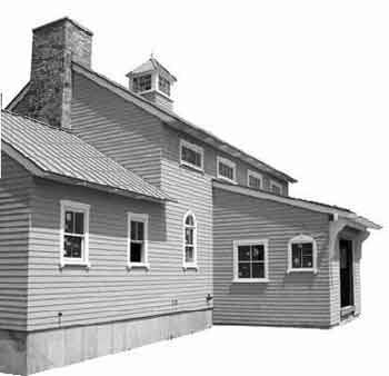

In this article, I’ll describe how we completed a decorative timber-rafter roof overhang for a new home on the coast of Rhode Island. The house was designed to look like a converted barn. Though it was stick-framed, it contained various timber-frame components both inside and out. The eaves details I worked on create the impression of heavy timber rafters, but in fact the roof was conventionally framed with 2×12 rafters on 16-inch centers.

There were two different overhang details on the project shown here. The eaves of the main roof have 22-inch-long shaped tails, while the overhang at the entry and garage has 3-foot-long tails that rest on a beam supported by large structural knee brackets.
