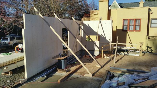

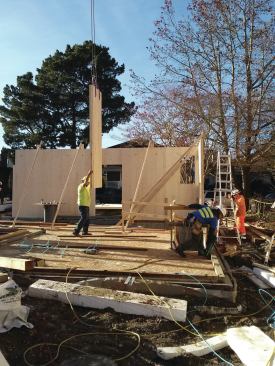

The wall panels had holes drilled through the upper portion. We put lifting straps through those holes, then had a worker or workers guide each panel into place.

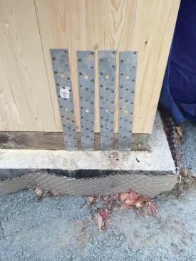

Like the foundation, the treated-wood sill plate must be perfect because of the fixed panel sizes. And of course bolts can’t protrude above the surface of the sill plate. All connections in a CLT project must be specified by a structural engineer; in this case the panels were fastened to the sill plate with vertical straps.
Once a wall panel is in place, it’s plumbed and braced the same as with any wall, though the panels are a lot stiffer than a stick frame and tend to need fewer braces. As with SIPs, the CLT wall panels were joined to one another with vertical splines: The last few inches at the edge of the panel were notched to receive a 1-inch-thick plywood spline.

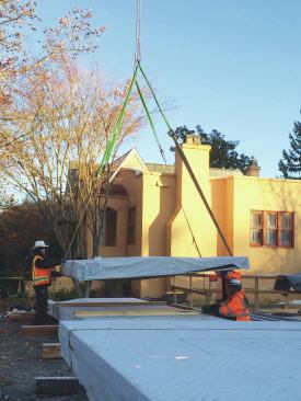

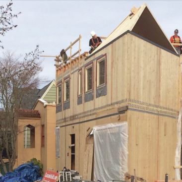

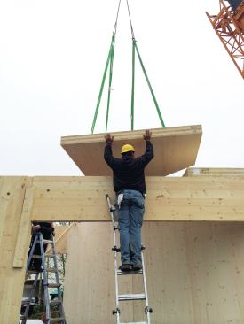

The second-story floor panels included what Structurlam calls Rampa connectors: threaded sockets embedded in the panels at key lifting locations. A harness bolts to these connections and to the crane’s lifting cable. After lowering the floor panels into place, we set and braced the second-story wall panels. Small Simpson clips—which, like the hold-down straps at the base of the wall, were specified by the engineer—held the first- and second-story wall panels to the intervening floor panel.

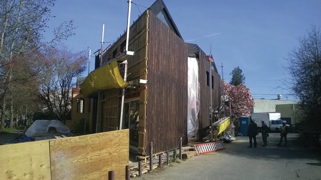

We flashed windows and doors with a fluid-applied flashing product called Prosoco FastFlash, wrapped the home with VaproShield WrapShield housewrap, then insulated it with Roxul Rockboard 80 panels. A grid of 1×4 treated battens formed a rainscreen that we covered with vertical board siding.

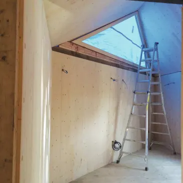

The roof was tricky. Although the home included roof panels, we framed over them with 2x8s so we could install polyisocyanurate insulation. We could have framed the roof without the panels, but the architect wanted the look of the CLTs on the inside.

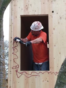

Our subcontractors had never seen this system, so in order to get accurate estimates, we worked closely with them to plan electrical and mechanicals. You can’t simply put pipes or wires inside the exterior walls. Our solution was to run outdoor-rated wire on the outside of the panels, then drill through the walls at each outlet location. We ran most of the plumbing in stick-framed interior partitions. In some places, we built chases for plumbing drops.
