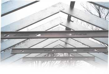

Some builders who frame with steel prefer to use wood trusses for roofing (see "," 6/00). Steel trusses are another option, but we've passed up both in favor of stick framing with conventional steel track and C-section material. Given the relatively simple roof forms we ordinarily use — most of our houses have simple gable roofs, with an occasional hip roof — this is the cheapest way to go, and it simplifies scheduling because we don't have to coordinate our construction schedule with truss deliveries or crane availability. Light but tough. The uniformity of steel is nice for walls, but it's especially evident in roof framing. Steel rafters are absolutely straight, so there's no need to inspect each one for crown before cutting. They're also lighter and easier to handle than wood. Yet the 16- and 18-gauge material that we use for joist and rafter stock is surprisingly rugged. We once had a set of steel rafters blown flat by a windstorm (the crew hadn't had time to brace them as the storm moved in), and although the attached ceiling joists were bent, none of the rafters were damaged. We were able to unscrew them from the joists and continue to use them. Wood rafters subjected to the same treatment would have been splintered beyond repair.

Our ridge detail eliminates both the ridge member and the clip angles. Instead, we simply cut a section of flange from the end of one rafter and overlap and screw the rafters together to form what is essentially a gusset (Figure 2). A C-shaped stud, typically 5 1/2 inches wide by 8 feet long, is screwed to both rafters as a collar tie.
Figure 2. In this simplified ridge detail, the flange of one rafter is notched and the two are lapped together and fastened with six #10 self-tapping hex-head screws. For maximum strength, the notched portion of the rafter should be as short as possible. This approach requires an engineer's approval.
