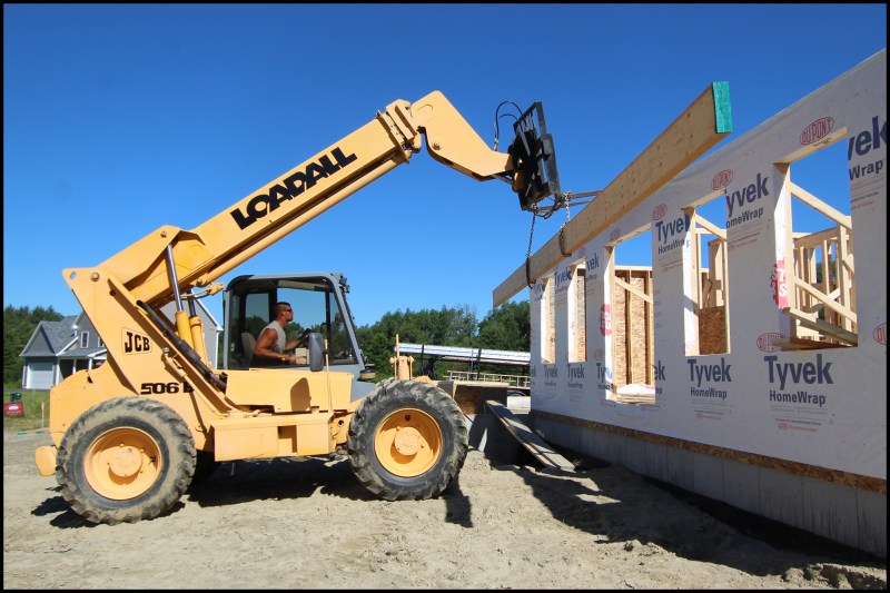

The author uses a telehandler to lift a partially built LVL beam into place. The beam was needed to support second-floor framing over a large, open-plan first-floor living room.

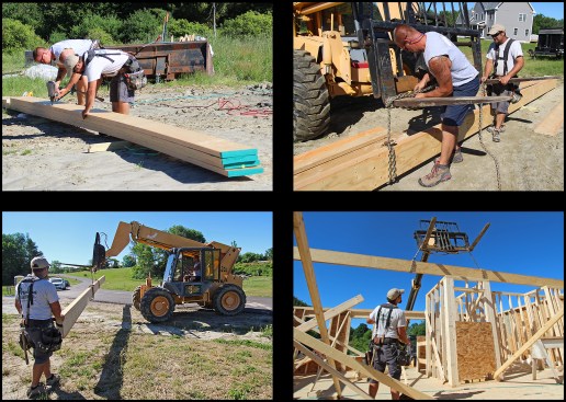

We began by field-measuring to verify both the main-beam and the support-beam locations, then cut the two longer LVLs to length. We then applied a continuous bead of construction adhesive to one of the LVLs and sandwiched the two together. We nailed off the beam with 16d nails in a robust nailing pattern, keeping the pair aligned by toenailing as needed. While still on the ground, we cut the main beam’s two shorter members and the support-beam LVLs to length.
The four-ply LVL beam was partially built on the ground. Here, the two longer, 32-foot lengths were glued and nailed together (top left), then chained to the telehandler’s forks, ready to be moved (top right). With the beam centered and balanced, it was lifted and slowly driven over to the home (bottom left). Loads can bounce and shift driving over the rough terrain of a jobsite, so it’s best to maintain a safe speed; at most, no more than a fast pace walk. The beam is guided into place via hand signals (bottom right).
Prior to tele-lifting the partial main beam into place, we installed the first of the doubled-up 12-foot-long support beams by hand from ladders (marking where the main beam would butt into it). Then, we attached the 32-footer to the forks of the telehandler with a pair of heavy-duty chains (double wrapping the beam and forks). I slowly brought the beam over to the front of the house and lifted it up and over the first-floor wall. Aaron hand-signaled me as we guided the beam roughly into place.

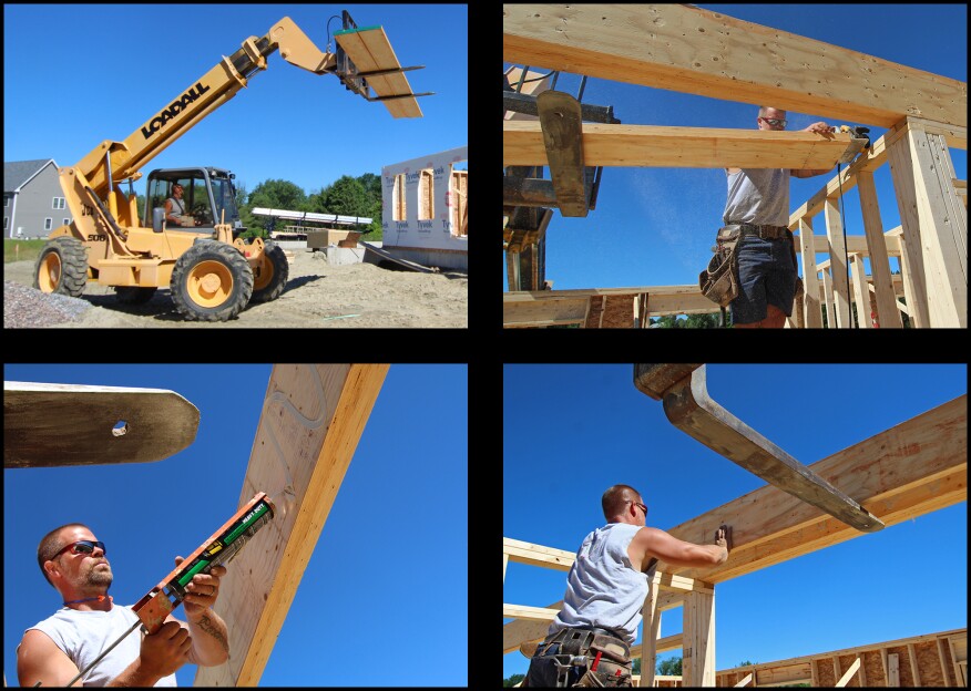

With 32-foot-long LVLs in place, the pre-cut 26-foot-long ones were loaded (centered and balanced) and slowly driven into place with the forks tilted upwards to prevent the LVLs from possibly sliding off the front (top left). Working off to the sides of the forks, the telehandler was used as a temporary work platform for laminating the third and fourth layers. Here, the author trimmed the LVLs to their final length (top right), then applied heavy-duty subfloor adhesive (bottom left). The LVL was tilted up into place (bottom right), then nailed off with 16d nails in a robust nailing pattern.
To help hold the main beam’s butted end in place, we nailed a temporary 2x6 block to the bottom of the support beam to serve as a seat. I further tweaked the main beam’s position with the telehandler’s articulating fork setup (tilting it side to side) to line it up with the location mark and rested it into its final position. Aaron end-nailed the butted end while I toenailed the beam to the top plate.

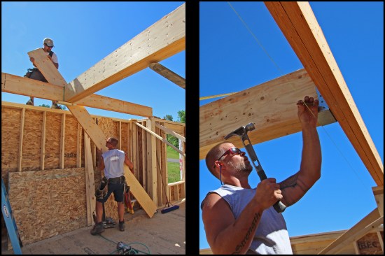

After they laminated the main beam’s four layers, the final step was to install the second 12-foot-long LVL of the support beam (above left) and a beefy beam hanger where the main beam butted into it (above right).
Next, I picked up the main beam’s two remaining 26-foot-long LVLs with the telehandler and lifted them in close proximity to the installed 32-footers (laid across the forks like a work table). On the ground, we had cut these shorter LVLs a little long so we could precisely mark and cut them in place. After we applied construction adhesive on the side of the installed beam, we flipped the third LVL into place and nailed it off. The fourth LVL was installed the same way. Aaron applied construction adhesive to the first support beam, then we lifted the second support LVL into place and nailed it off. Finally, I installed the beefy beam hanger, while Aaron started marking off the I-joist spacing for the floor system.
