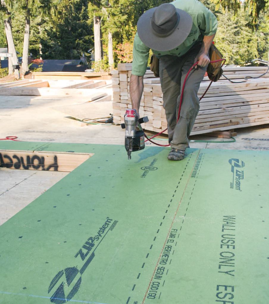

Zip wall panels are premarked for 16-inch and 24-inch on-center stud layouts.

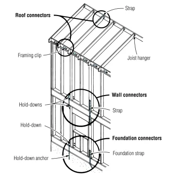

Continuous plywood across wall planes and tighter nailing schedules are crucial elements of structural design for seismic and high-wind areas.
A variety of metal connectors are used to tie a house structure together and create a continuous “hold-down” path from roof to foundation.

Shear walls are designed to resist racking. Both interior and exterior shear walls have rigorous nailing schedules, with nails spaced only 2- to 3-in. apart on panel edges (below). Nails must be held back 3/8 in. from the edges of sheathing panels and 3/8 in. in from the edges of framing members. Also, they must be staggered vertically (below).
