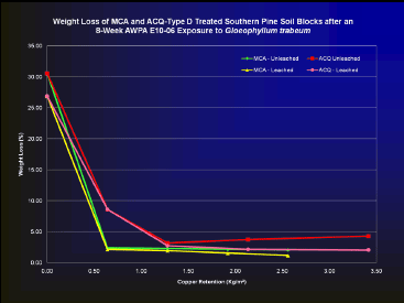

Osmose and Michigan Tech’s “Wood Protection Group” included these graphs in a joint presentation to a 2008 meeting of the International Research Group on Wood Protection (slides published with permission). It’s true that Osmose has publicized test results for its product that are based on AWPA standard testing. For example, these charts (above) are from a presentation by Osmose wood scientists, along with professors from the Michigan Tech’s ” Wood Protection Group,” at a 2008 meeting of the International Research Group on Wood Protection, a global association of more than 300 wood scientists from 51 countries. The upper chart compares the performance of MCQ-treated wood with ACQ wood in AWPA standard “soil block” tests, where small chunks of wood are placed in jars of wet soil inoculated with different fungi. In that example, MCQ performed as well as or better than ACQ. The lower chart compares the performance of MCQ lumber treated to different preservative concentrations, or “retentions.” It’s clear that the higher treatment levels provide the best protection — test stakes treated to the highest levels suffer essentially no decay for 52 months in ground exposures in Hawaii. (Download a PDF of the complete presentation.) Match the Exposure For end users, the most significant issue is not which type of lumber to use — any brand on the market will have passed some form of code-sanctioned testing to demonstrate its durability. More important is that the lumber be rated for the exposure it faces. For posts in the ground, that means either the AWPA “UC 4” (“Use Category 4”) label, or the ICC “Ground Contact” rating. These days, not all wood in the market is treated to those levels, so it’s important to check the labels carefully. Beyond that, however, the word on the street is that for rough exposures, it’s still possible to special-order lumber that is treated with the old, arsenic-based pre-ACQ and pre-MCQ treatment. CCA lumber, which has stood up to decades of outdoor, ground-contact exposure on continuously monitored test plots, is still available through some supply chains. In recent months, I’ve spoken to deck builders in Oregon, Massachusetts, and Oklahoma who all told me that for ground contact exposures, they still use CCA wood when they feel that it’s appropriate.
