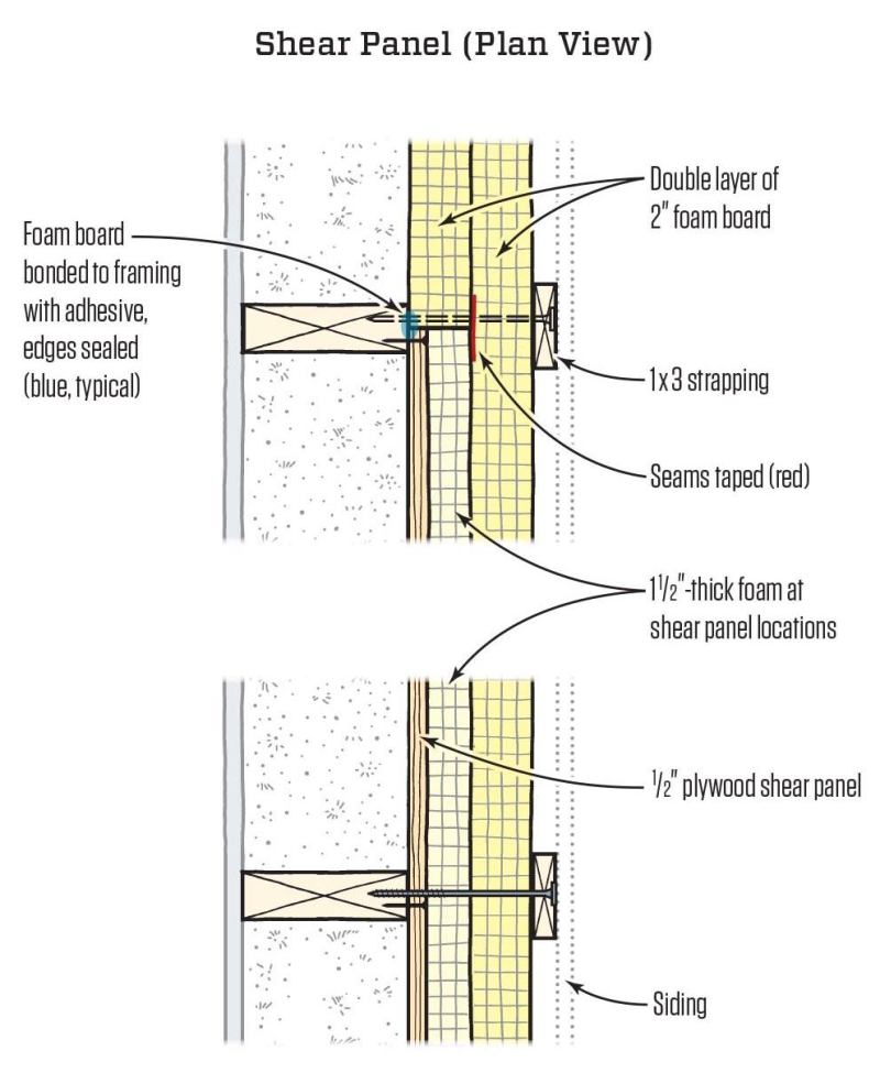

Structure. Foam sheathing doesn’t provide racking resistance. Diagonal bracing, continuous structural sheathing, or intermittent shear panels are imperative beneath rigid foam (see “Bracing Walls for Wind,” July/13). When using intermittent shear panels, the insulation thickness will need to be varied to accommodate the shear panel thickness (Shear Panel).

Two layers. To help reduce water intrusion, install foam panels in two layers. The first layer goes in vertically, with the panel edges sealed to the framing with an adhesive, such as OSI’s GreenSeries adhesive (osipro.com).The second layer goes in horizontally, with the field joints between layers staggered and corner edges woven together (Corner). This way, any water that gets past the first layer will hit a solid panel rather than another seam.
With foil-faced foam, tape all seams and terminations for added protection. Taping XPS or unfaced EPS is not recommended. Foam panels will shrink slightly and will expand and contract with changes in temperature. This movement destroys the tape bond on unfaced material. The bond to foil, however, seems to last. (Dow Weathermate tape, building.dow.com, seems a popular choice for taping foam because it sticks even to wet surfaces.)
