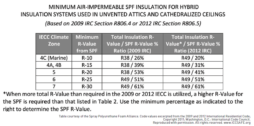

To control condensation in hybrid roof assemblies, the code sets minimum R-values for the air-impermeable layer (column 2) and its percentage of the total R-value of the system (columns 3 and 4). R-value requirements have not increased since the 2012 code. While this table addresses the R-value of SPF, the R-value percentages also work for rigid-foam insulation installed above the roof sheathing.

Q: I need to insulate the cathedral ceiling of a large building, which is located in western Virginia (climate zone 4) with hot summers and cold and snowy winters. The insulation contractor recommends insulating the rafters with a 1-inch layer of closed-cell foam, followed by fiberglass batts. Is this “flash and batt” system a good choice in my climate? Do I need to worry about condensation?

The bottom line is that the R-value of the outer air-impermeable layer of insulation needs to be great enough to keep that first condensing surface above dew point. The colder the climate, the greater the R-value needs to be in that air-impermeable layer. For determining the thickness of the air-impermeable layer in a flash-and-batt system (also called flash-and-fill), there is guidance from both the most recent energy codes as well as the Spray Polyurethane Foam Alliance (SPFA). The table above shows how much R-value the foam layer should provide to a flash-and-batt insulation system, both as a minimum R-value and as a percentage of the total.
Using that SPFA table, let’s look at our example in western Virginia (climate zone 4A). Virginia has adopted IRC 2015, but with some amendments. One of those amendments keeps the climate zone 4 ceiling-insulation minimum total value at R-38, the 2009 IRC level. For the building in the question to comply with both the building code and SPFA guidance, the spray-foam “flash” layer would need to equal an R-value of 15 (column 2), which represents 39% of the 2009-required total minimum ceiling R-value of 38 (column 3). If the R-value of closed-cell spray foam is 6.5 per inch, then 2 1/3 inches of spray foam would be the minimum requirement to meet the Virginia code.
If you decided to go beyond code for total ceiling R-value, let’s say to R-60, then use the ratios shown in the fourth column. (While these ratios reflect the amount of spray foam needed to control condensation in a flash-and-batt system that meets the higher 2012 insulation requirements, they are safe to use for higher-R assemblies as well). That is, the flash layer needs to be 31% of the total insulation R-value, which means R-18.6. To achieve that R-value with spray foam, the layer would need to be 2.9 inches thick.
