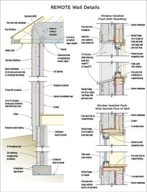

Moisture infiltration into wall cavities is a concern anywhere, but especially in climates like Alaska’s, where extreme winter temperatures and a short drying season exacerbate the problem. To address the shortcomings of standard frame construction, my company has adopted an insulation and air-sealing method developed by builders and researchers working with the Cold Climate Housing Research Center (CCHRC; cchrc.org) here in Fairbanks. Nicknamed the REMOTE Wall System (for Residential Exterior Membrane Outside Insulation Technique), it involves installing a barrier membrane on top of the structural sheathing, followed by several inches of rigid foam insulation. The membrane provides an air seal, while the thick insulation keeps the sheathing and framing above the dewpoint temperature and so prevents condensation from occurring in the wall.
The rigid foam can be supplemented by installing a lesser amount of fiberglass batt insulation in the frame wall. The goal is to increase the wall’s total R-value from the inside, but without allowing the sheathing to cool to the dewpoint. It’s a balancing act: You have to put enough insulation on the outside to keep the sheathing membrane warm, but not too much on the inside else you’ll isolate the sheathing and framing members from indoor heat. This is critical, because besides providing an air barrier, the membrane — either by itself or in combination with the sheathing and exterior insulation — acts as a vapor retarder. So there’s no doubt that in a REMOTE wall, interior moisture vapor will be stopped at the sheathing plane.

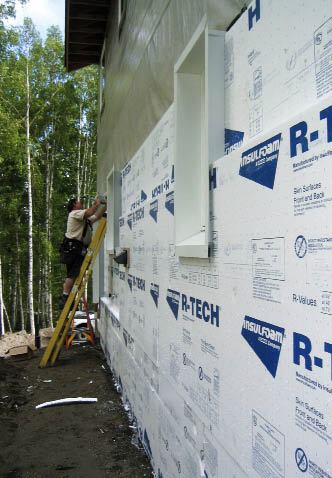

I generally use R-Tech IV EPS (expanded polystyrene) on the exterior. It’s made by Insulfoam (800/248-5995, insulfoam.com) and has an R-value of 4.8 per inch at 40°F. (The R-value actually increases as temperatures drop.) I typically install 6 inches — two layers of 3-inch. R-Tech has a polyethylene facing that helps it shed water, though the edges are unfaced. This has led to some concern that moisture might get into the foam board at joints and be unable to get out. But CCHRC tests in the rainy southeast of Alaska have shown that R-Tech performs well in REMOTE walls and that moisture entrapment is not a problem.

Covering the house with rigid foam board creates a potentially tight structure, but it’s the barrier membrane applied to the sheathing that does most of the work.
The earliest REMOTE walls used peel-and-stick membranes; this produced an incredibly airtight, waterproof shell but it was expensive. So most builders switched to less expensive materials — 6-mil poly or, in very wet zones, vapor-permeable drainage wraps such as Tyvek StuccoWrap or DrainWrap. Poly works fine in Fairbanks, which is fairly dry; in rainy southern Alaska, the Tyvek products are the usual substitute for peel-and-stick. The reason is that rainwater might travel through a nail hole and get trapped behind poly, whereas using a housewrap will allow for evaporation to the outside. (StuccoWrap or something similar is also used on REMOTE houses that receive an EIFS cladding, per the EIFS manufacturer’s specifications.)

Performance test. Installing the barrier membrane and exterior foam doesn’t in itself guarantee that the structure is airtight. The only way to do that is to do a blower-door test. This is a critically important step in achieving a tight shell, and you have to do it when you can still access the leaks. If you hold off doing the blower-door test until the insulation and drywall are installed, it’ll be too late.
We wait until the electrical, plumbing, and mechanical subs have done their rough-ins, then hang the drywall over the ceiling air barrier. The blower door depressurizes the interior and shows us where the leaks are. There’s no insulation in the stud bays at this point, so it’s easy to seal wall leaks from the inside, using spray foam and acoustical sealant. The attic has not yet been insulated, so we can plug those leaks working from above. When the house is finished, an independent energy rater performs a second blower-door test as part of an energy audit.
Our goal is an airtightness of 0.6 air changes per hour at a pressure of 50 pascals (ACH50) — the same standard required for a Passive House. We’ve achieved this with the 6-mil poly barrier and have gotten down to 0.3 ACH50 with a peel-and-stick membrane. The best we’ve done with StuccoWrap is 0.8 ACH50.
