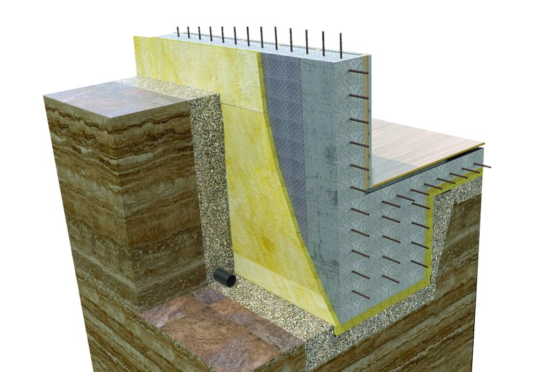

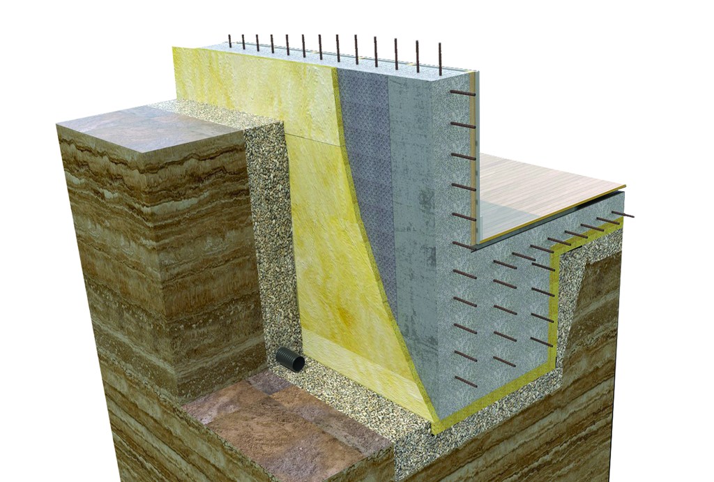

This rendering by California architect Dan Hruby shows the insulated footing detail for developer Tyson Dirksen’s project in San Francisco’s Russian Hill neighborhood. The heavily reinforced footing supports three stories of concrete and steel construction set underneath an existing wood-frame house, which was lifted one story to create a fourunit multifamily building. Two inches of EPS insulation isolates the building’s lower apartments from the surrounding earth.

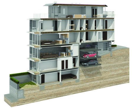

A showcase multifamily retrofit still under construction by San Francisco developer Tyson Dirksen will add three stories of concrete and steel structure under an existing historic wood-framed house. Engineers okayed EPS insulation around the new lower portion’s reinforced footings.

“There’s a lot of cool stuff going on there,” says project architect Dan Hruby (visualizeitbuilt.com). “We’re on a hillside there. And we’re carrying five stories, so half of that is underground, essentially, with just the one end open. We’ve got a view of the Golden Gate Bridge straight out of the west side, with balconies on that end.” But along with the view comes direct afternoon sun.
Code required the new lower stories to be Type I noncombustible concrete and steel construction, and the engineering analysis resulted in a structural requirement for massive reinforced concrete footings and concrete walls. Passive House consultant Katy Hollbacher (who is also a civil engineer) recommended insulating the concrete elements with 2 inches of exterior EPS foam.
Foam around a foundation can be a hard sell in a seismic zone. In a previous Passive House project, Hollbacher says, a different engineer refused to even consider putting insulation under the thickened edge of a structural slab—even for a one-story house on a flat site. “Some people just like to have a quick reason to say no,” says Hollbacher, “because they’re not used to doing it.”
In that case, Hollbacher dropped the issue—even though the uninsulated slab edge accounted for 4% or 5% of the one-story home’s calculated heating load. “You have to pick your battles,” she says. But for the Tyson Dirksen project, she says, “Erevan just said, ‘Okay, I understand what you’re trying to go for, and we will make it work.’”
Hollbacher herself is on the fence about insulating foundations in the California climate. “The engineering part shouldn’t be a challenge,” she says. “I think more of a challenge is the constructability—just the phasing of getting insulation in there, and the dirt not falling in … it’s something people haven’t done before, and it’s tedious. It’s doable, but it’s a pain. And the energy savings is small, so the cost-effectiveness argument is serious. Realistically, you’re probably only saving a few dollars a year.”
Still, says Hollbacher, “What I love about this mind-set of Passive House is, hey—just do the envelope right from the start. It’s going to be there for a long time, and the added cost to do some of this detailing is negligible on the scale of the project. Don’t even spend the money to do all these software runs and calculate the cost effectiveness—spend that money on mitigating it instead. Just do it.”

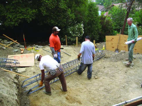

“It’s important to understand that this project had already completed plan check before it was modified for Passive House,” said Wallis in an email to JLC. “If we had been starting from a blank slate, some simpler options might have been possible. But conditions at the site include California seismic conditions, moderately steep slope, expansive clay soil over bedrock, and bedding planes somewhat parallel to the slope, producing a tendency towards creep. As a result, moderately deep piles were required at the low side of the addition, with spread footings sitting on the bedrock on the high side of the house. Everything is supported on the bedrock, not sitting on loose soil above the bedrock.”
Foundation workers set rebar cages for deep structural piers into the hillside for Sylvia Wallis’ high-performance addition.

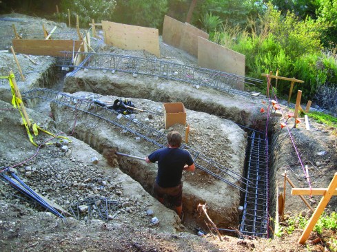

A worker shovels out the trench for grade beams that will support the stem wall for the unconditioned crawlspace under Sylvia Wallis’ addition.

“The soils report called for a combination of passive earth pressure and friction from the piles and footings to resist the lateral forces (primarily seismic),” Wallis continued. “So the connection of the foundation against the bedrock was significant. All foundation excavations had to be hand-cleaned of all loose material to maintain this connection.”
“The standard Passive House solution is an unvented basement or slab on grade, either of them completely surrounded by insulation,” said Wallis. “You can see how difficult it would have been to try to insulate around them, even if the structural engineer had allowed it.”
“So instead,” Wallis concluded, “the insulation was moved up to the underside of the raised floor. The difficult detail then is the connection of the floor to stem wall (impossible to have continuous insulation and difficult to do the air barrier). But in the benign L.A. climate, the thermal bridge is not huge and can be calculated into the model without a terrible penalty.”
