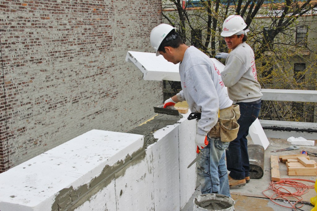

Parapet walls for low-slope roofs can be insulated with a rigid-foam wrap that integrates into the wall insulation and the roof insulation of the building, as shown here in a Passive House project from 2016.

Insulating parapets. For parapets, says May, the go-to solution is a relatively straightforward insulation wrap. “In New York, you’ve mostly got concrete-masonry-unit construction, and so you’re going to have a parapet that in most of our projects is going to be built of three or four courses of CMU,” says May. “And if you’re doing an exterior insulated building, you just take that insulation and run it right to the top of the parapet, over the top of the parapet, and then down the inside face of that parapet, so that it connects to the roof insulation. (We try to do exterior roof insulation on every project that we can.)”
It’s simple enough, says May, “but the complexity comes in things like ‘OK, how do I mount a handrail bracket, or how do I mount my parapet cap? How do I mount a satellite dish?’ So often we’re doing a layer of either plywood or some sort of topping board in order to cover that insulation, and that gives you something to attach to.” The plywood is adhesively applied to the exterior insulation, which is itself adhesively applied to the CMU wall, May says.
Heavier items such as satellite dishes may require pre-positioned blocking, says May. “It’s like doing kitchens,” he says, “where you build with an eye towards hanging cabinets. You put blocking where you need it. You build out the structure in a way that you can fasten those components later on. But you need to plan for it ahead of time.”

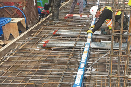

Isolating balconies. Decks in a low-rise wood-frame building are simple enough to isolate from the main building, simply by constructing a freestanding self-supported platform. But cantilevered balconies in typical urban concrete buildings are a more difficult problem. In theory, you could wrap insulation out over the balcony, down the front, and under the underside, but May says that approach is problematic. “There are huge waterproofing issues with that, never mind the basic threshold issues.” Instead, May prefers the approach of isolating the balcony from the main structural slab using a premanufactured insulating component such as Shöck’s Isokorb or Halfen’s HIT. These components are designed to be installed at the floor slab edge before concrete is poured. They consist of an insulating foam core, stainless steel rebar, and a concrete or steel bearing surface. “The companies make many lines of product,” says May. “You just have to find the right one. The different prices and capacities will depend on the situation.”
“The stainless steel rebar is still a thermal bridge, but it’s much less conductive than mild steel,” says May. “It’s not perfect. It doesn’t eliminate the thermal bridge entirely. But it does a good job—certainly good enough that we don’t worry about things like surface temperature or condensation or mold growth.”
The technique is far from a no-brainer, says May. “It has to be done by a structural engineer. It has to be specified carefully, and the team has to understand the install details, to tie in the stainless steel to the rebar mat of the main building. So it’s certainly not something you would slide into the plan five minutes before you build. But it’s definitely doable, and we’ve done it on quite a few projects.”
The Isokorb thermal break from Schöck creates an insulated structural connection between a balcony and the main floor slab of the building. The engineered connection is installed before concrete is poured, and it’s integrated into the rebar mat of the slab.
