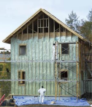

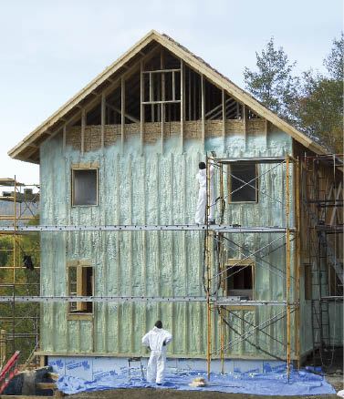

Exterior Spray Foam
After the framing was complete, our insulation sub sprayed the exterior stud cavities with 3 1/2 inches of Demilec HeatLok Soy (877/336-4532, demilecusa.com), which has an R-value of 7 per inch. Because of the XPS spacers, this leaves 2 inches of the stud cavities unfilled, creating a drying space behind the siding (Figure 5).
Figure 5. After the exterior stud bays were sprayed with 3 1/2 inches of closed-cell foam, workers let in blocking for a future addition, then covered the foamed stud bays with housewrap (top). The windows are fastened directly to the bucks, then flashed to the housewrap with flashing tape (bottom left). The window openings were framed with a 30-degree flare to allow in more light (bottom right).
The exposed rim joists in the basement and first story were also sprayed, along with the raised heels in the attic (Figure 6). The insulation contractor we work with is meticulous about checking moisture content before spraying; this is particularly important anywhere moisture could become trapped behind closed-cell foam, which has very low moisture permeability. So, for example, he made sure the OSB sheathing was dry before spraying foam on the inside, just as he would before spraying foam against roof sheathing in a hot-roof application.

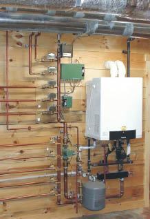

Our Manual J calculations predicted that the design heat load for the 2,000 square feet of main living area would be about 22,000 Btu; adding the basement and office space above the conventionally framed garage to the calculations brought the total design heat load to almost 60,000 Btu. To allow us to efficiently heat all three zones with one system, we installed a Buderus GB142 propane-fired modulating condensing boiler (800/283-3787, buderus.com). This is a 96 percent efficient wall-mounted unit with a microprocessor control, an outdoor temperature sensor, and variable output ranging from 22,500 to 75,000 Btu (Figure 7). The hydronic system has a total of five zones - one for each of the two upstairs bedrooms and one each for the main floor, basement, and garage office - and uses individually controllable panel radiators to deliver the heat. Mechanical whole-house ventilation is supplied by a Venmar EKO 1.5 heat-recovery ventilator (800/567-3855, venmar.ca), which is also zoned.
Figure 7. The home's heat is supplied by a Buderus wall-mounted propane boiler (top left). The condensing unit has variable output between 22,500 and 75,000 Btu, depending on how many of the five zones are calling for heat. The 80-gallon Superstor Solar storage tank (top right) receives hot water from two roof-mounted solar thermal collectors (bottom); backup is provided by an electric heating element. To the left of the storage tank is a Venmar EKO 1.5 heat-recovery ventilator.
We installed a pair of roof-mounted flat-plate solar hot-water collectors and expect that they will supply at least 50 percent of our domestic hot-water needs. Water heated by the collectors via a heat exchanger is stored in an 80-gallon SuperStor tank (800/323-9651, htproducts.com), which also has a backup electric heating element to take advantage of the 7-kilowatt grid-tied PV array up on the roof. Since we're in a rural area with frequent power outages, our net-metered electric system is backed up by both a generator and DC batteries.
