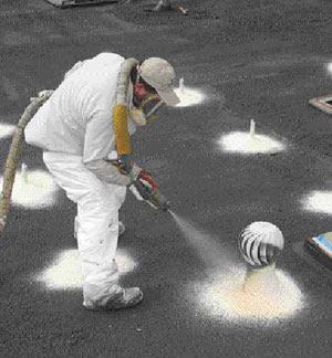

Spraying Foam
The foam can be sprayed when the prep work is done and the weather conditions are right. The roof deck must be dry and the air should be relatively warm. There should be little wind. If too much moisture is present, it could disturb the chemical reaction that creates the foam, resulting in a degraded product that leaks. Excessive wind could increase overspray and negatively affect the texture of the foam surface.
The temperature of the surface to be coated should be warm (above 50 degrees). Applicators must be willing to shut down operations when conditions aren't right.
To handle overspray, we mask skylights, sidewalls, shingles, and anything else we don't want foam on. Masking the edge metal allows us to apply foam up and onto the edge. We spray detailed areas like edges and roof jacks first and do the field later.
The applicator pulls up on the masking paper while spraying foam up and onto the edge metal.
After spraying such detail areas as edges, curbs, and roof jacks, he sprays the main body of the roof.
A worker uses a grinder to bring the foam flush to the edge metal and to make it slope properly into scuppers and drains.
Since the foam cures quickly, we can walk on it within a couple of minutes.
