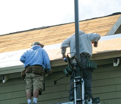

Roof Down

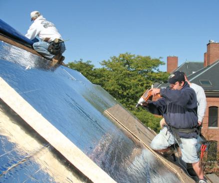

We started with the roof, stripping it down to the sheathing, then installing two layers of 3-inch Dow Thermax foil-faced polyisocyanurate insulation, per the recommendation of Betsy Petit and Kohta Ueno of Building Science Corp. in Somerville, Mass. We staggered the joints in both directions and taped the seams to prevent air movement through the edge gaps, then laid 5/8-inch plywood sheathing on top and attached it to the rafters with 10-inch FastenMaster HeadLok screws. We then installed the roofing right on top.

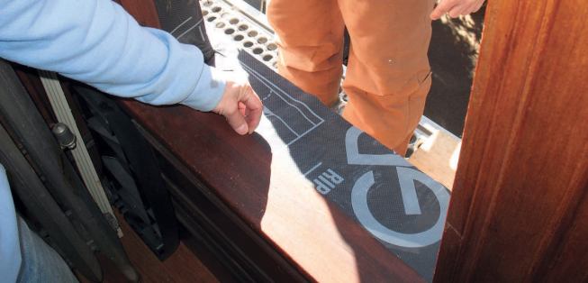

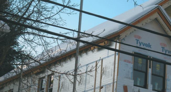

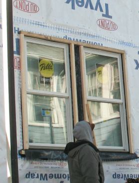

Next we stripped the old shingle siding and installed the Tyvek. Because the housewrap was serving as both a drainage layer and an air barrier, we secured the bottom edge to the sheathing by embedding it in silicone caulking and taped all the seams with Dow Weathermate construction tape. We like this particular tape because it can be installed regardless of the weather. It sticks to wet surfaces and holds well even if it’s left exposed for a long time.

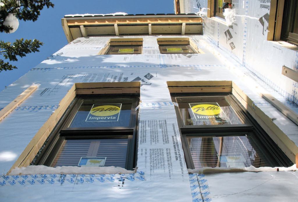

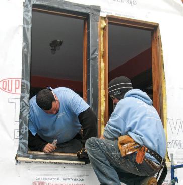

Installation of the replacement windows followed, with the double-glazed Pella Impervia double-hung replacement units sized so that we could keep the original interior trim intact. We flashed the rough openings with Grace Ice & Water Shield, then taped the housewrap to the peel-and-stick. As the windows were installed, we also attached 2-by blocking around the perimeters to provide backing for the deep exterior jamb extensions that we would be adding.

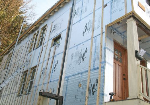

Wrapping the Walls

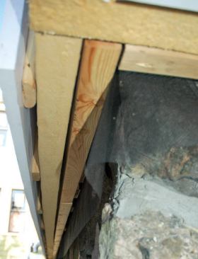

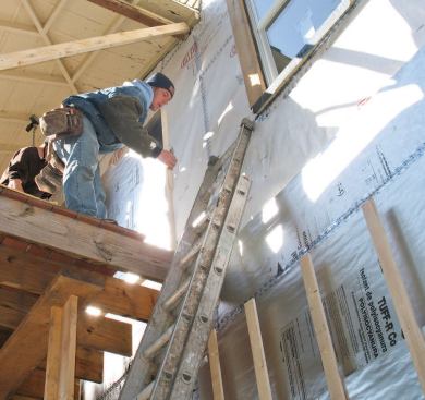

Over the housewrap we placed two layers of 2-inch Dow Tuff-R foil-faced polyiso. We started by fastening a 2x4 ledger across the bottom of the wall to provide support for the first layer of foam as well as nailing for the skirtboard. As we were installing the 2x4, we stapled insect screening to the wall; this would later be folded up and fastened to the strapping to keep bugs out of the air space.

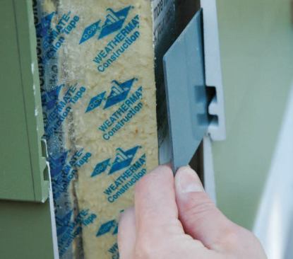

We laid out the foam board with drainage in mind, making sure to stagger the field joints and weaving the edges on outside wall corners. That way, any water that gets past the first layer will hit solid foam rather than another seam. We also taped the seams on both layers.

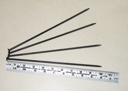

Wall strapping. We held the foam board in place temporarily with long screws, then followed with 1x3 vertical strapping screwed to the studs. To prevent noticeable waves and bumps in the clapboards, we took pains installing the strapping, making sure the surface of each piece was in the same plane as the pieces on either side. This is a good idea for any type of siding, but it was critical in this case because the PVC clapboards the owner had chosen — called NuCedar — have an interlocking edge that would make any irregularities in one course show up in the next course. The nailing surface needs to be almost perfectly flat — there’s little tolerance for error.
We fastened the strapping to the underlying wall framing with 6-inch HeadLok screws, then pulled string or laid a straightedge over the faces. By tightening or loosening the screws, we could adjust the depth by 1/8 to 1/4 inch to create a flat wall. Because it was an old house, we needed every bit of that adjustment in some areas.
Siding support. We’ve been asked several times whether, with 4 inches of foam between the strapping and the sheathing, we worry that the weight of the plastic siding will bend the screws and cause the courses to sag. Although the job isn’t that old, we’re confident that we won’t have such problems. Another job we did had an identical rain-screen detail over 4 inches of foam — but in that case we installed fiber-cement siding, which is heavier than cellular PVC. Revisiting that job after four years, we saw no evidence of sagging.[[Paginatehere]]

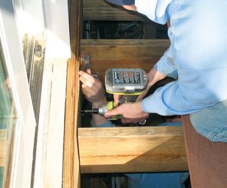

Porch Ledger Over Foam
Installing the porch ledger was tricky, because we had to maintain the strength of the connection as well as the thermal break provided by the foam. We did this by cutting back the porch joists and removing the original ledger. We securely fastened a new 2-by ledger over the Tyvek into the framing, then covered it with 1/2-inch rigid foam. This created a total thickness of 2 inches, matching the first foam layer. We then installed the second layer of 2-inch foam, placed a second ledger on top of that, and again fastened through to solid framing. We flashed the ledger with Ice & Water Shield and aluminum.
Window Jambs

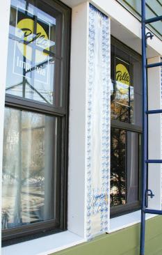

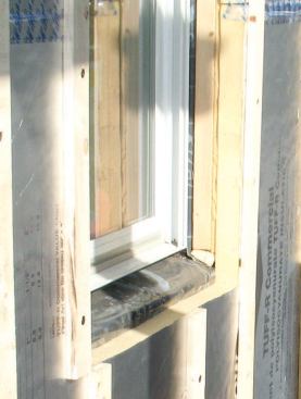

Anytime you add rigid foam to the outside of the shell, you end up having deep jamb extensions either inside or outside, depending on whether the windows are installed on the face of the sheathing or the face of the foam. We’ve done it both ways. On this job the windows were “innies,” meaning we had to add exterior jamb extensions to cover 4 inches of exposed foam plus the 3/4-inch strapping.
This is without a doubt the most vulnerable part of the installation; if there’s ever a problem, it will be because of a leak around the windows. For that reason, I usually build and install the extension boxes myself, taking care to tape and seal every possible leakage point.
On this house I used cellular PVC boards supplied with the siding package, screwing the pieces together with stainless steel trim screws and applying silicone caulk in every joint. The sill has a 10-degree slope. I bedded the backs of the extension boxes in a generous bead of silicone on the window frame, then screwed them into the wood blocking around the perimeter. On the outside, I taped the sides of the extensions to the foil surface of the insulation board.

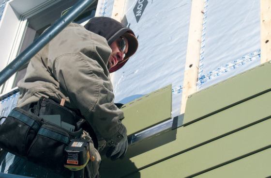

PVC Siding
The owner chose NuCedar siding to reduce maintenance costs; according to the manufacturer, it never needs to be painted. We found that it was scratch-resistant and easy to handle. Not only is it lighter than fiber cement, but it doesn’t give off any nasty dust when it’s cut.
The siding package we received included 1/2-inch clapboards, metal starter strips for the first course to lock into, flat plates for bonding adjoining clapboards, and premilled header, casing, and corner trim. In the fall of 2008 NuCedar cost about 10 percent less than red cedar and about three times more than fiber cement.
We completed the job over the winter, in temperatures that varied from mild to bitter cold. The siding was flexible when temperatures rose above 50°F but became brittle at colder temperatures, which meant we had to handle the boards more carefully to keep them from cracking.
Accommodating Movement

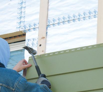

Besides needing to keep the wall plane flat (the process I mentioned above), you also have to pay attention to movement, because any vinyl product expands and contracts a lot with changes in temperature. The siding we installed included a nailing flange at the top of each piece. It’s fastened in place with roofing nails, but to allow for movement you have to leave a 1/16-inch gap between the nail head and the siding material. This meant nailing by hand, which probably added the most time to the job. (A few months after this job, NuCedar came out with a clip system that allows you to install the siding with a nail gun, but I haven’t used it so can’t comment on its effectiveness.)
Field seams are backed with a vinyl bonding plate that’s glued to the back of the siding with PVC cement. The plate holds the siding in place but serves no waterproofing role. Because the plates are adhered with PVC glue, installing them in cold weather can be problematic; in fact, a few of the ones we installed on cold days later came loose.

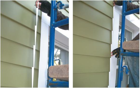

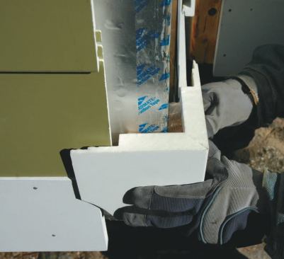

The NuCedar trim goes on after the siding and has a rabbeted edge that overlaps the clapboards, giving them room to move. To allow for movement, the ends of the PVC clapboards have to land in the middle of the rabbet. The back of the trim boards have a mark showing where the clapboards should end, so we snapped vertical reference lines on the foam at this point. At outside corners we also used a block of trim to confirm our spacing as the siding went up.
 The package comes with sawtooth-shaped inserts that close the gap between the trim and siding. This method no doubt works fine on the flat walls of a new home, but — as mentioned previously — with the rain screen over the old frame we had to constantly adjust the strapping depth to get the inserts to fit tightly. These details add a lot of time to the job; the siding took about a third longer to install than wood clapboards, though admittedly this was our first experience with the product.

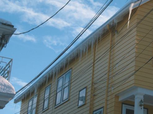

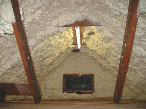

No More Ice Dams
On the inside, the owner added 10 to 12 inches of Icynene to the unfinished attic, bringing the total roof R-value to 60 or more. Added to the blown-in cellulose already in the wall cavities, the additional 4 inches of foam on the outside brought the wall R-value to around 39.
The benefits of the insulation retrofit were obvious to us as the job proceeded: Ice dams that used to form on the roof after every snow — a sign of heat leaking through the top of the building shell — were gone. New Fantech HRVs on the inside ensure good air quality for the two units in the building, and the occupants describe the house as warm, draft-free, and quiet.
