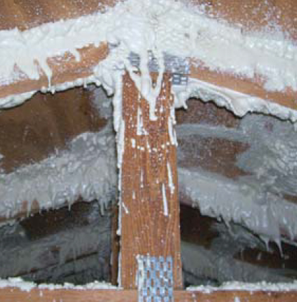

When a roof is not likely to be replaced anytime soon and the sheathing nailing can't be verified (on a tile roof in good condition, for example), contractors in Florida are beginning to employ the "fillet method." This practice uses closed-cell spray foam to help bond the roof sheathing to existing framing and provide a secondary water barrier.

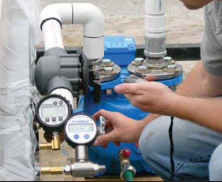

During the study, the assembly was placed on a pressure chamber and a vacuum pump drew a vacuum that was increased in 15-psf intervals until the assembly failed and the sheathing popped off the framing. For the fully foamed assemblies, this occurred at around 240 psf. The assemblies that had ccSPF fillets installed failed at 160 psf. The assemblies with sheathing alone nailed only with nails (6/12 schedule) failed at about 75 psf.

The uplift study also evaluated the benefit of installing a “fillet”: a 3×5-inch bead of ccSPF in the corners between the sheathing and the roof framing. The fillet method effectively doubled the uplift resistance of the baseline assembly of 2×4 framing on 24-inch centers sheathed with 1/2-inch OSB nailed on a 6/12 schedule.
