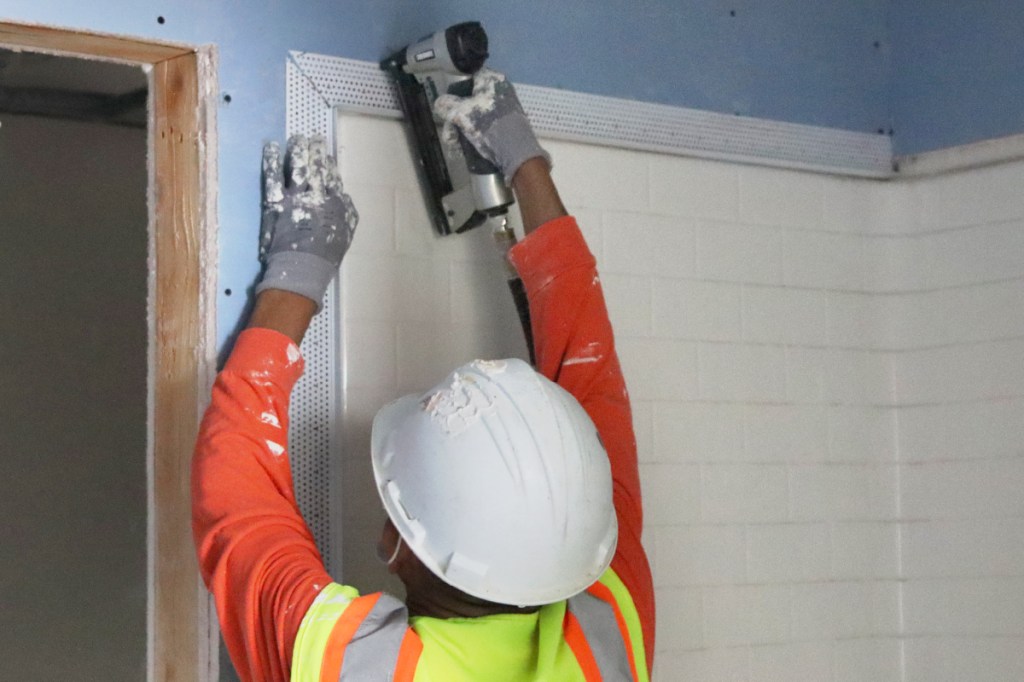

Shower Bead eliminates many of the steps involved with finishing around tub enclosures, with an extra-wide vinyl flange that bridges the gap between the enclosure and the drywall. It’s an all-in-one solution built to save you time and material. Because this bead is vinyl, it won’t rust or serve as a food source for mold — problems that frequently occur with metal beads and paper tape, respectively, in moisture-rich environments like these.
“It's always been in the back of my mind there's got to be a better way to do it,” says Southern California Interiors Estimator/Project Manager Anthony Anderson. “The caulking infill is just a lot dirtier. We've always been looking for a cleaner, faster way to infill those tub flanges, and when my superintendent showed me this, it's just quicker, cleaner installation all around … We've been jamming through, as opposed to the standard infill, mesh tape, and all that. I think, in the long run, it'll be better because we don't have the contraction with the building itself and with the moisture in the air being in the restroom. I think, in the long run, it would overall just be a better product at that application.”
