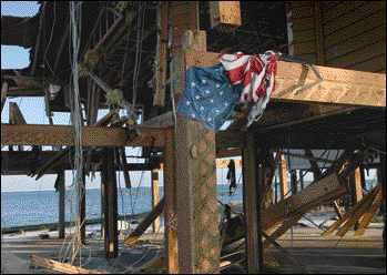

Hurricane Ivan devastated older homes in Pensacola built before enactment of the Florida Building Code. The hurricanes of 2004 — Charley, Frances, Ivan, and Jeanne — tore across Florida, resulting in more than $22 billion in projected losses, making it the most expensive storm season in U.S. history.

Officials at the IBHS and the Tallahassee-based Federal Alliance for Safe Homes (FLASH) praise the structural performance of Florida Building Code-built homes. “It’s clear to us that, post-Hurricane Andrew, we’ve gotten much better at keeping the roof on,” said Leslie Chapman-Henderson, the alliance’s president. But IBHS officials noted that the homes often suffered serious internal damage, and observed frequents failures involving: Soffits. The alliance’s investigations near Punta Gorda after Hurricane Charley found repeated instances of wind blowing out soffits and pushing rain into attics, where soaked insulation collapsed ceilings, ruining interiors.
Ceramic roof tiles. Investigators said that while hurricane-resistant shingles were an improvement, other ceramic tiles often broke off, damaging not only homes but whole neighborhoods. “You end up with a debris storm that is not just air — it’s air laced with tiles,” said Scott Schiff, a professor of civil engineering at Clemson University and director of the university’s Wind Load Test Facility. Chapman-Henderson noted that screwed-down tiles performed better than those attached with mortar.
Pool cages and lanais — those aluminum structures protecting pools or shading verandas and patios — were frequently toppled over or blown away.
