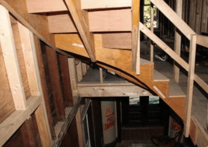

Temporary, 2x4 guardrails, screwed together for easy removal, provide fall protection for workers using the rough stair.

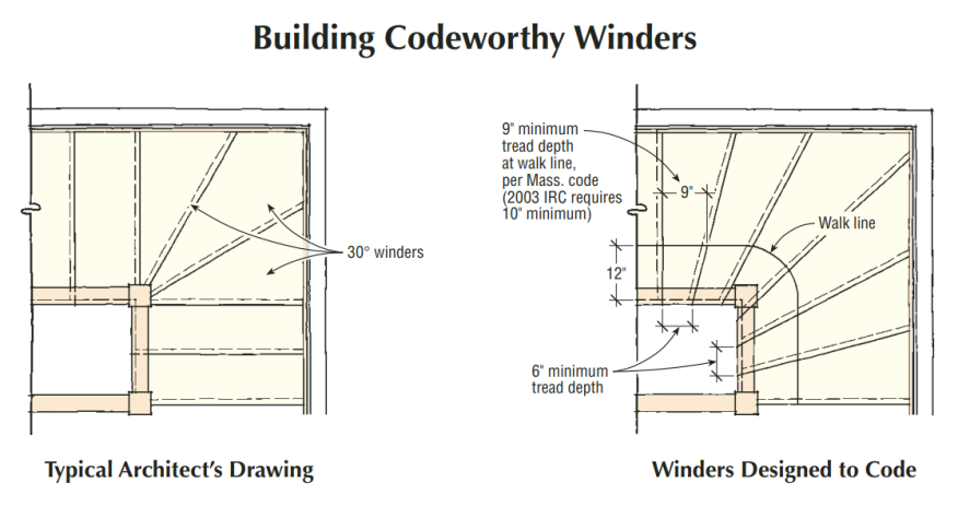

For this particular job, the architect’s drawing showed a new stair winding up to the third floor, a design appropriate for the period but one that I immediately knew wouldn’t meet code. As drawn, the U-shaped stair called for three 30-degree winders at each right-angle turn. While such stairs are typical in homes built before, say, 1960, they’re no longer allowed by code. Old-style winder treads typically taper to a point at the outside corner, whereas current building codes won’t allow any part of a tread to be narrower than 6 inches. This is too bad, because these traditional stairs are comfortable to climb, look good, and take up less space. Nonetheless, we had no choice but to redesign the stair to meet code.
The walk line. Those old stairs are comfortable to climb because they follow one of the most important rules of stair safety: The net run of the treads, measured at the walk line, should be constant from the top to the bottom of the stair. The walk line is an imaginary line that represents the path the center of your body takes when climbing and descending a stair — typically about 15 inches in from the centerline of the handrail. Try it: Stand on a stair with your hand on the handrail, center the end of your tape measure on the handrail, and check the distance to your belt buckle.
When designing winding stairs, this rule — plus making certain that all risers are the same height — is critical. When your feet move the same height and distance forward with each step, the tendency to stumble on a stair is greatly reduced. That’s why the walk line is my first consideration when I draw a stair in plan view.
Though I prefer to lay out winders with a 15-inch walk line, my local code uses 12 inches, and requires a 9-inch minimum tread width at the walk line. So to pass inspection I have to make sure I meet that requirement. For the stairway shown here, which was only 36 inches wide, I used a 12-inch walk line for layout.

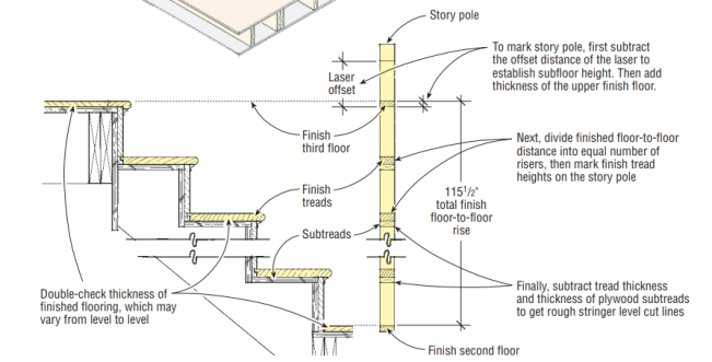

Architect plans can be unreliable, so I always mark accurate site measurements on a story pole — a clean length of 1-by lumber 1 to 2 inches wide and a little longer than the floor-to-floor distance. The story pole provides an accurate, full-size stair elevation condensed onto a tall stick. By working things out on the story pole first, I eliminate the cumulative error that can otherwise result from rounding riser heights to the nearest 1/16 inch. Even a 1/32-inch deviation per rise can turn into a 1/2-inch disaster when multiplied by 15 risers.
I label the pole’s bottom end for reference and square the thickness of the finish flooring across it, up from the butt. I begin by marking the rough-to-rough floor distance directly on the pole. The two points, where the stair begins and ends, usually aren’t directly over each other, so I use a laser level (Stabila LAX 100, 800/869-7460, www.stabila.com) to find the difference in elevation. I stand the pole in the stairwell at the starting riser location and shoot a level reference line over to it from the top riser location. The floor in a rehab often is not level, so I always work from the walk line. While I’m at it, I also mark corresponding laser line marks on the surrounding stairwell walls for later reference when installing the stringers. Then I put away the laser — I won’t need it again.
After making sure of finish floor thicknesses, the author lays out a story pole for the stair, first using a laser level set at the walk line to establish reference points.
Next, after laying the pole flat, I subtract the offset distance of the laser beam (the distance of the beam above the subfloor). This mark establishes the subfloor height. Then I add the thickness of the upper finish floor above the subfloor reference line. This gives me the finished floor-to-floor distance of the stair at the walk line, which I quickly divide into an even number of risers using a Construction Master calculator. I mark these on the story pole — these are the finish tread heights — and then subtract the tread thickness, as well as the 3/4-inch thickness of the plywood subtreads, to get the rough stringer level cut lines.

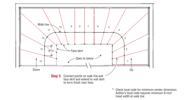

I locate the handrail centerline — typically half of a baluster’s thickness in from the face-skirt line — and offset the walk line 15 inches from there. I then divide the walk line into even tread segments, relying on the formula 2 risers + 1 tread = 25 inches. On a residential stair, the risers must measure between 6 1/2 and 8 inches; as riser height increases or decreases, the tread run changes accordingly.
The total floor-to-floor rise for this stair was 115 1/2 inches. I broke it down into fifteen 7 11/16-inch risers and fourteen 9 3/4-inch-wide treads, measured at the walk line.
My next step is to mark tread divisions on the face-skirt line by dividing its total length into equal segments. Depending on the total run and configuration of the stair, there may be a number of “common” treads — full-width treads that occur in a straight section of the U. You can determine this by trial and error, trying to keep the narrow ends of the wedge-shaped treads as close to the minimum 6 inches as possible. The stair shown here had two commons.
With the tread spacing marked equally along the face-skirt line, I connect those marks to the divisions along the walk line and extend each line to the wall. This gives me the complete finish riser line for each step; from there, it’s easy to mark the back of the 3/4-inch finish riser, then the back of the plywood subrisers, which tells me where the rough stringer plumb cuts go. (I also add other details to the drawings as needed — nosing, wall skirts, newels, baluster, and railing.)

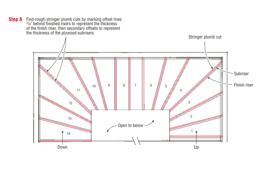

I use LVL for stringers; it’s 1 3/4 inches thick and very stable, and comes in a variety of widths. Because the winders cross the stringers at different angles, the stringer shapes become complex and require wider-than-normal stock. For this stair, I used 16-inch-wide LVL.
All the information I need to lay out each stringer is right on my full-size plan. I draw 3/4-inch offset lines behind the finished risers and inside the skirtboard line to represent their respective thicknesses. Then I draw secondary offsets 3/4 inch behind those lines to represent the thickness of the plywood subrisers. I draw the stringers according to their actual spacing on the plan. This stair was only the minimum allowable 36 inches wide, so I used three stringers. On any stair wider than 36 inches, I use four stringers. I draw the stringers with a red pencil to distinguish them from all the other pencil lines.
This is where the story pole becomes indispensable. By holding it at right angles to the stringer lines, I can accurately mark the risers where they occur on each stringer — no two stringers will be alike.

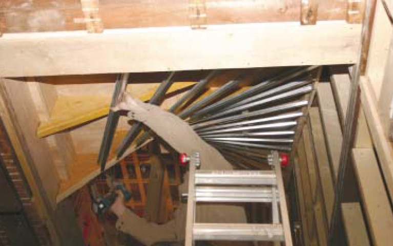

I make all of my stair carriage components in the shop — this one took a couple of days — and then haul them to the site for assembly as a rough stair. Installation usually takes two guys about a day to complete. We lag the stringers together at the turns, and to the walls, with 5/16-inch-diameter GRK star-head screws (GRK Fasteners, 807/474-4300, www.grkfasteners.com), driven with an impact driver fitted with a Torx bit. The screws are rated for shear and provide a rugged connection.
Starting at the bottom and working up, we glue and screw the plywood treads and risers, using construction adhesive to eliminate squeaks. We continually check the stringer heights with the story pole and check the subtreads for level, front-to-back, and side-to-side accuracy. We try to keep the face side of the stair about 1/8 inch higher than the wall side to counteract deflection. Once all the treads and risers are attached and the glue dries, the entire carriage becomes one strong, monolithic structure. Before leaving the site, we install all the blocking needed to secure finish components — for instance, where railing meets wall — and install a temporary 2×4 handrail that’s screwed, not nailed, together for easy removal.
