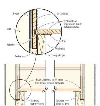

Housing the treads and risers in the skirtboards further improves the quality and appearance of a stairway. On an enclosed stair, this is done by routing the stair profile on one skirtboard 1/2 inch deep and on the other only 1/4 inch, inserting the tread or riser into the deeper rout first, and then sliding it back to fit in the shallower side. The treads have to be 1/2 inch longer than the distance between the skirtboards. However, this method makes it nearly impossible to use that interlocking joint at the back of the tread. So, I’ve developed a modification that lets me house the treads and risers and still lock the risers onto the treads.
First, I cut and fit the skirtboards and temporarily tack them in position. Then I trace the tread and riser profiles for the entire stair directly on both skirtboards, using a short mockup of the assembled parts. I use a torpedo level to check that the treads are level and the risers plumb. So that I can use the interlocking joint, I place a 1/4-inch shim behind the riser before tracing the profile. This 1/4 inch is equal to the tongue’s projection on the back edge of the tread; it allows me to drop the riser behind the tread and force it forward onto the tongue. Of course, this means that the slot I rout for a 3/4-inch-thick riser must be 1 inch wide.

Finally, I give the routs just enough play to allow the treads and risers to slide in the housings without resistance. Shims force the resulting hairline gaps closed on the visible side, while adhesive fills them from the underside and prevents squeaks.
With the skirtboards completely routed and the housings checked for a smooth fit, I give them a light sanding and install them permanently, using nails and construction adhesive. I let the adhesive set for a couple of days before proceeding. The adhesive is important because I commonly insert shims under the treads to compensate for the stringer shrinkage and distortion mentioned earlier. As I work up the staircase, the incremental pressure of this successive shimming may force the skirtboard upward if it isn’t securely glued in place. I learned this the hard way years ago, when I reached the top of an installation only to find the skirtboard hovering 1/2 inch above the floor — not a good moment.
Once the skirts are installed, I can fit each tread into the deeper skirt first and then slide it back into the shallower side, leaving both ends embedded 1/4 inch. I always dry-fit every component first before applying adhesive. I add a bead of construction adhesive to the bottom edge of the routs and to the tops of the rough stringers. I pull the tread forward, shim it upward as needed, and face-nail it — with one nail at each end — into the outside stringers. I always drill pilot holes and hammer nails in by hand; hardwood stair treads are pretty tough on nail guns; also, the nails don’t always set properly — and I find that they don’t hold as well, either.

Routs in the skirtboards are cut to allow the treads and risers to be deeply inserted on one side, then withdrawn halfway to engage the opposite, shallower skirt.
Routs in the skirtboards are cut to allow the treads and risers to be deeply inserted on one side…
…then withdrawn halfway to engage the opposite, shallower skirt.

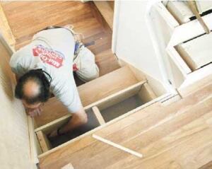

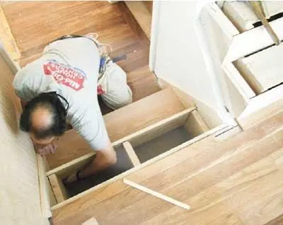

At this point I drop the riser in behind the tread, again checking first for a good, smooth fit. I then apply adhesive to the stringers and to the locking groove and drive the riser forward onto the tongue of the tread. A precut 1/4-inch shim driven between the riser and stringer permanently locks the riser onto the tread. Adding screws from the back is almost redundant at this point, but it’s cheap insurance and can slightly improve the joint’s appearance.

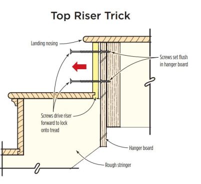

By the time I arrive to work on the stairs, the finish flooring — including the overhanging nosing at the upper landing — is often already installed. This precludes both shimming the top riser forward onto the tread and screwing it through the backside. Instead, I have come up with a trick that works quite well. First, to make the joint tight, I bevel the tongue so it’ll wedge into the groove like a cork in a bottle. Next, I dry-fit the riser in the skirts and drive finish nails at the four corners, through the riser into the stairwell header. Then I pull the nails and remove the riser. Where the nails marked the header, I drive four drywall screws flush. I apply construction adhesive to the riser groove and the skirtboards, reinstall the riser, and drive 2-inch or longer screws through the original nail holes. When these screws hit the drywall screwheads, they can’t penetrate further, so the threading action pulls the riser forward to lock onto the tread. I let the adhesive set for a couple days, pull the screws, and fill the holes.
