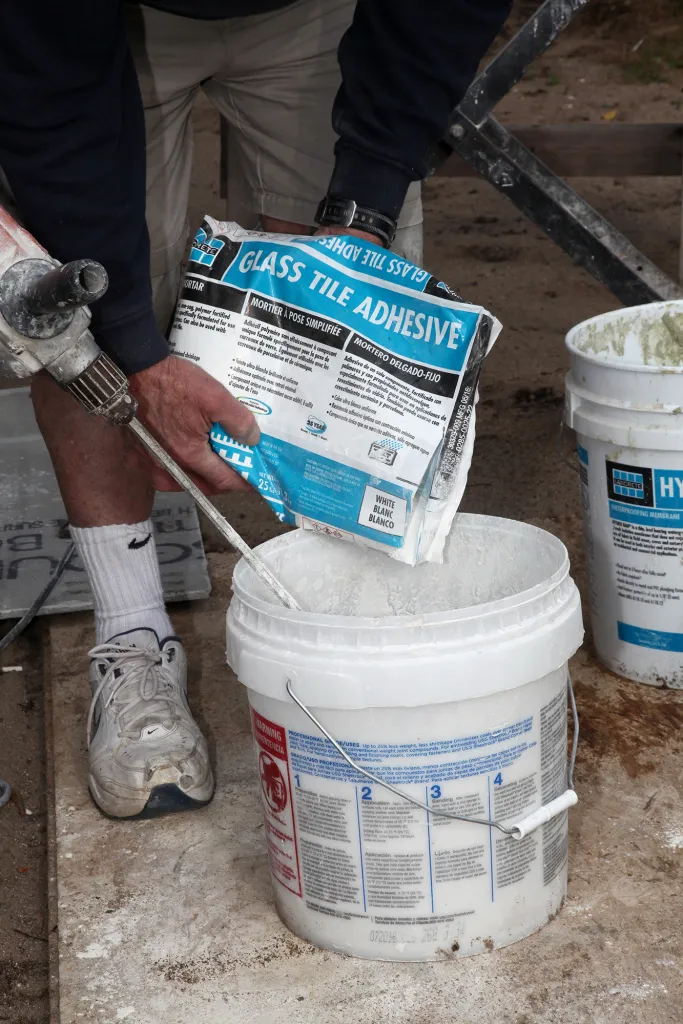

Certain types of tile, such as glass tile, may require thinset that’s designed specifically for that tile. Here, the bag of adhesive is clearly labeled for its purpose.

In the last few decades, new types of tile have been gaining popularity, and many require different formulations of thinset for proper adhesion. For example, porcelain, which has taken a large share of the market, is very dense and has a low moisture-absorption rate. Glass tile—also popular—has an even lower absorption rate. These properties call for some sort of modified thinset. Because these types of resilient tile are being made by a variety of tile companies in a variety of configurations, thinset manufacturers have had to create different types of latex/polymer-modified mortars to work with the specific tile that’s being installed.
It can make a big difference which type of thinset is used with each product. Manufacturers of specialty products like glass tile almost always specify the type of mortar to be used. Even some natural stone tiles require a specific type of mortar, and installers should not take those recommendations lightly. The formulation of today’s tile is just too complex, so instructions must be followed exactly.

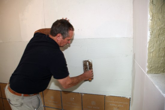

Thinset is applied to the wall in accordance with the tile manufacturer’s instructions.
So the answer to this confusing question about which thinset to use—and when—is pretty simple: Always follow the tile manufacturer’s recommendation. The manufacturer knows its products, and more importantly, it warranties its products only when they’re installed according to its recommendations. If the tile manufacturer doesn’t recommend or require a specific type of thinset, then go by what the thinset maker recommends for the type of tile you’re installing. The TCNA is also a good resource. The TCNA Handbook is the best all-around reference for all types of tile information, and the TCNA has technicians on hand who can help you choose the right thinset.
