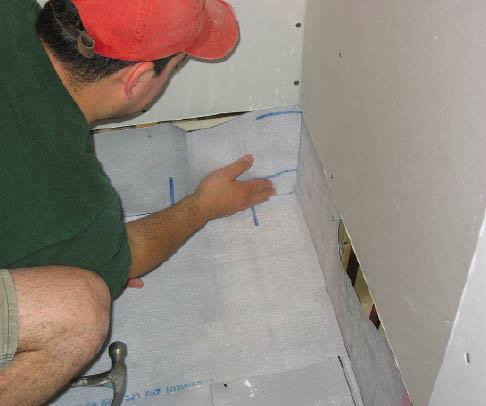

Installing the Liner
To prepare for installation, we remove the duct tape from the drain, loosely install the bolts, and spread a bead of Noblesealant around the perimeter of the flange. The sealant prevents water from seeping out between the drain and the liner should the drain ever clog.
We install the liner by positioning it so the creased edges butt to the walls and curb. This is one time when it helps to have a second set of hands. When working alone, I spot the studs and blocking with Noblesealant so the liner hangs in place when I press it up onto the wall.
Vertical leg. To turn the liner up, I put one hand under the folded material at the center of the wall and press it tightly into the corner between the wall and the floor. I use my other hand to lift the material against the framing, then secure it with a nail or screw, keeping the fastener within an inch of the top edge. I repeat this process all the way around the shower, working from center to corner and fastening every 12 inches or so. There will be excess material at the corners, which I take up by making a triangular fold. When the liner is properly installed, it should lie flat against the framing and fit tightly into every corner. If the material cuts across a corner, it will form an unsupported cove — a natural stress point that might someday spring a leak.
Drain attachment. At this point of the installation process, the liner runs over the drain but doesn’t lie flat because the bolt heads are holding it up from below. So that the bolts can pass through the liner, we use a utility knife to cut small X-shaped slots over the heads of each one, then squeeze them through the openings. Next, we mark the drain opening by turning the upper half of the drain upside-down, placing it over the bolt heads, and tracing its opening onto the membrane with a Sharpie. We then remove the upper half of the drain, cut out the drain opening, and reinstall it right side up.
To prevent water from escaping through the bolt holes, we remove the bolts one at a time, squirt Noblesealant into the holes, then reinstall them. We tighten the bolts just enough to slightly compress the pan liner. This is not like tightening lug nuts — snug is good enough.
Over the curb. The final step is to run the membrane across the curb, which we do by slitting the liner vertically at the ends of the curb and folding the flap out. This leaves studs exposed at either end of the curb. We cover the exposed framing with Chloraloy patches, gluing them on with Noblesealant. There’s still a small hole at the three-way corner where the liner was slit. We patch this area by gluing on a preformed corner dam from Noble.
It’s critical that every part of the liner lie flat and tight against the substrate. Bulky folds and loose areas will prevent cement board from lying flat or create hollow spots under a mortar-bed substrate.
When the glue on the liner has cured, we plug the drain and test the pan for leaks by filling it with water and then leaving it overnight or until the inspector has signed off on it.
